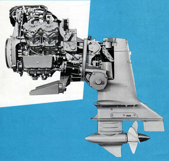

I have an OMC Deluxe with the original 2-stroke V4 DU engine. Does any other engine (preferrably an inline 4 cyl) mate to the original OMC outdrives?

No. If you want a nice OMC setup - find the heavy-duty "Stringer" outdrive (they made them forever) and stick a Buick odd-fire V6 on it. That was the best setup on these. The small bullet case was limited to around 100 HP and even then was stressed. The large case could take 300 HP.

says the same outdrive was used with Chevy II 153 (110 - 120 hp) I-4's (model CU).
