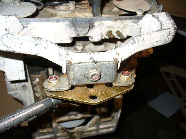

There most certainly are links that can work for your application. You would need one of these to adapt the steering at the carry handle, plus an anchor to the transom. I have the adapter plates, plus one of the clips that goes on the carry handle...

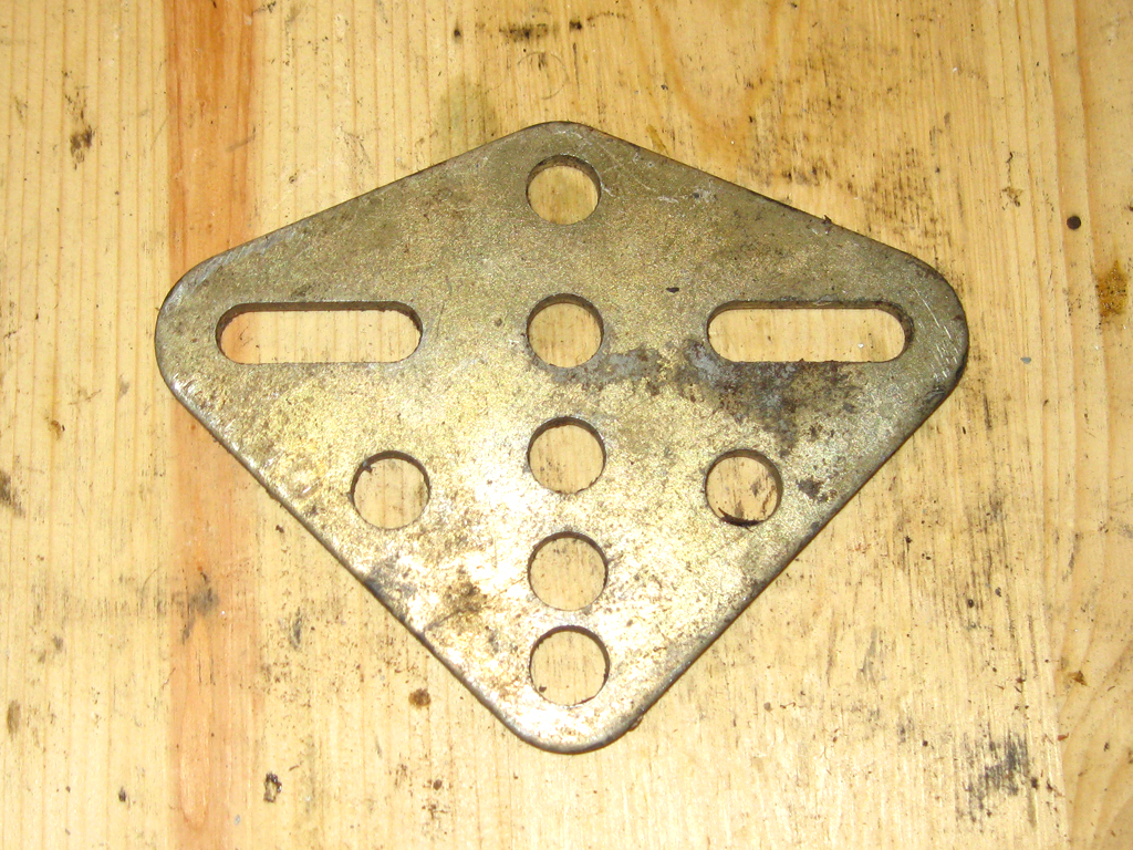

Here is the plate...

great idea!!! do i still have to have the link? or does end of cable go to plate? i know i have to have the transom anchor,which is still there.do you have those for sale? and how much? i would be very interested in buying them.on my other post "unknown project boat",it will be going on that...thank you for your quick response!!..Rat
Re:Steering link for 1956 Johnson 15hp 14 years 1 month ago #69435
The link arm only comes into play when the steering cable runs through the tilt tube, or is similarly anchored.
I'll have to look, but I don't think I have any of the cable transom anchors. I believe you can get them through Teleflex.
Re:Steering link for 1956 Johnson 15hp 14 years 1 month ago #69451
I have the cable anchor.it is mounted to transom,but would be interested in the plate and clip,I had an old cable clip for carry handle, but can't seem to find it now,thanks for the help!!! ....dale
