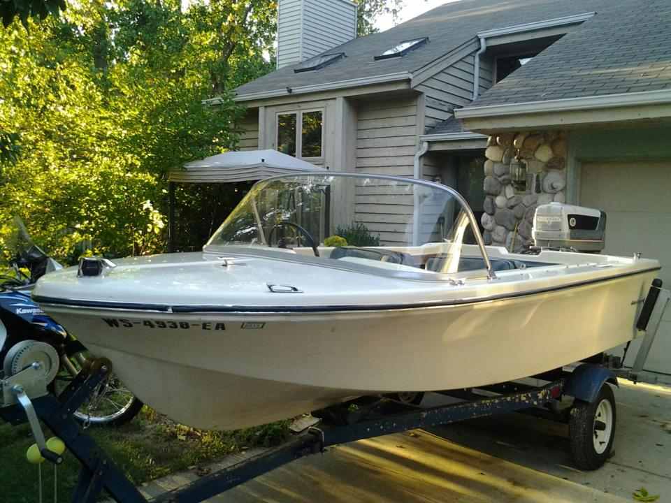

How about posting a photo of the motor? How nice is the cowling? It's a rare bird.
Verne
Re:swaping lower unit on fat fifty 13 years 5 months ago #78060
Here is a partial view, all original, except for bungee strap. I had her out on the lake today for fist time since replacing low speed screw seals and being layed up for winter. She started great but was a little cold blooded when throttling up at first. Once fully warmed up she ran great. I will have to adjust the auto-choke. After some idle quality adjustment she purred like a kitten during idle and low speed. She is as smooth as most modern engines.

In a nutshell, the fat 50 parts used in the conversion / swap were the cowling, front and rear lower pans, transom bracket, flywheel with magneto pulley, recoil housing, bendix,external front throttle linkage, and rewiring for the use of the fat 50's wiring harness, control box, and dash ignition. The only "loss" is the 75's charging system. But, I have a 31 series AGM battery, magneto which is self powering and doesn't draw electricity, and a recoil starter. Sweet and simple.
