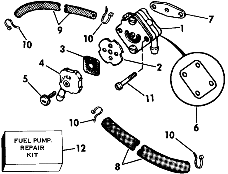

Now back to the fuel pump. I know that it is brand new as the guy gave me the oem box with the old parts pieces in it but I cannot stop the leak. I have disassembled and reassembled a few times and am wondering if I have all the pieces together properly. I fear that these fuel pump assembly's are not serviceable because I cannot find any detailed diagram of the pump internals and only find the following which is no help:
***UPDATE*** I did just find a great explanation on rebuilding these fuel pumps:
www.leeroysramblings.com/Rebuilding_fuelpump.htm
Thoughts and ideas are greatly appreciated. One last lingering question...how does the spring actually attach to the shifter arm?

I have the fuel pump issue fixed thanks to LeeRoy's ramblings....a great site full of info...especially this fuel pump rebuild.

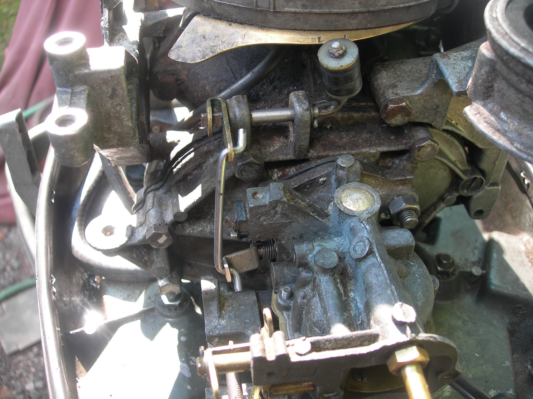

Thanks Kerry....yesterday I found out how the only way to get the synch adjusted properly as there was no more room using the screw on the cam under the plate. I loosed the nut on the throttle arm which allowed the throttle butterfly to close completely...I then adjusted the cam to have the roller lined up between the two marks on the cam and them lifted the throttle arm moving the roller to touch the the cam and tightened the screw while holding it. Now the cam will travel to the marks before engaging the throttle...as it should.
As for the throttle handle....I always know where I am by watching the cam on the roller but would like to get it fixed properly. The problem is in the gears between the pilot shaft on side of motor moving the cam and the rod/gear being driven by the throttle handle.(the one after the elbow). I need to figure out how to remove that rod to reposition the gear mesh correctly. I will figure this out in time.
BUT...this right now has nothing to do with my idle issue. Even though I have the cam advance corrected...it will still not idle. It has to be in fuel delivery and I think it is possibly needing the proper packing on the idle needle. I am going to get a rebuild kit soon and am tearing the carb off again in prep for a complete R&R.
Anybody have a picture of a late 60's tiller OMC showing how the shifter arm is held by the spring(which I am missing)?

Re:'68 Johnny 20hp Questions 14 years 1 month ago #69073
  • Kerry
  • Posts: 675
  • Karma: 51
Re:'68 Johnny 20hp Questions 14 years 1 month ago #69074
  • barnfinder
  • barnfinder's Avatar Topic Author
  • Posts: 447
  • Karma: 5
Thanks again Kerry... that is a different version that I have already but the diagram is the same and I see the spring for the shift rod but can't really tell where exactly it connects?
I will pour thru the rest of it to maybe figure out my idle issue.

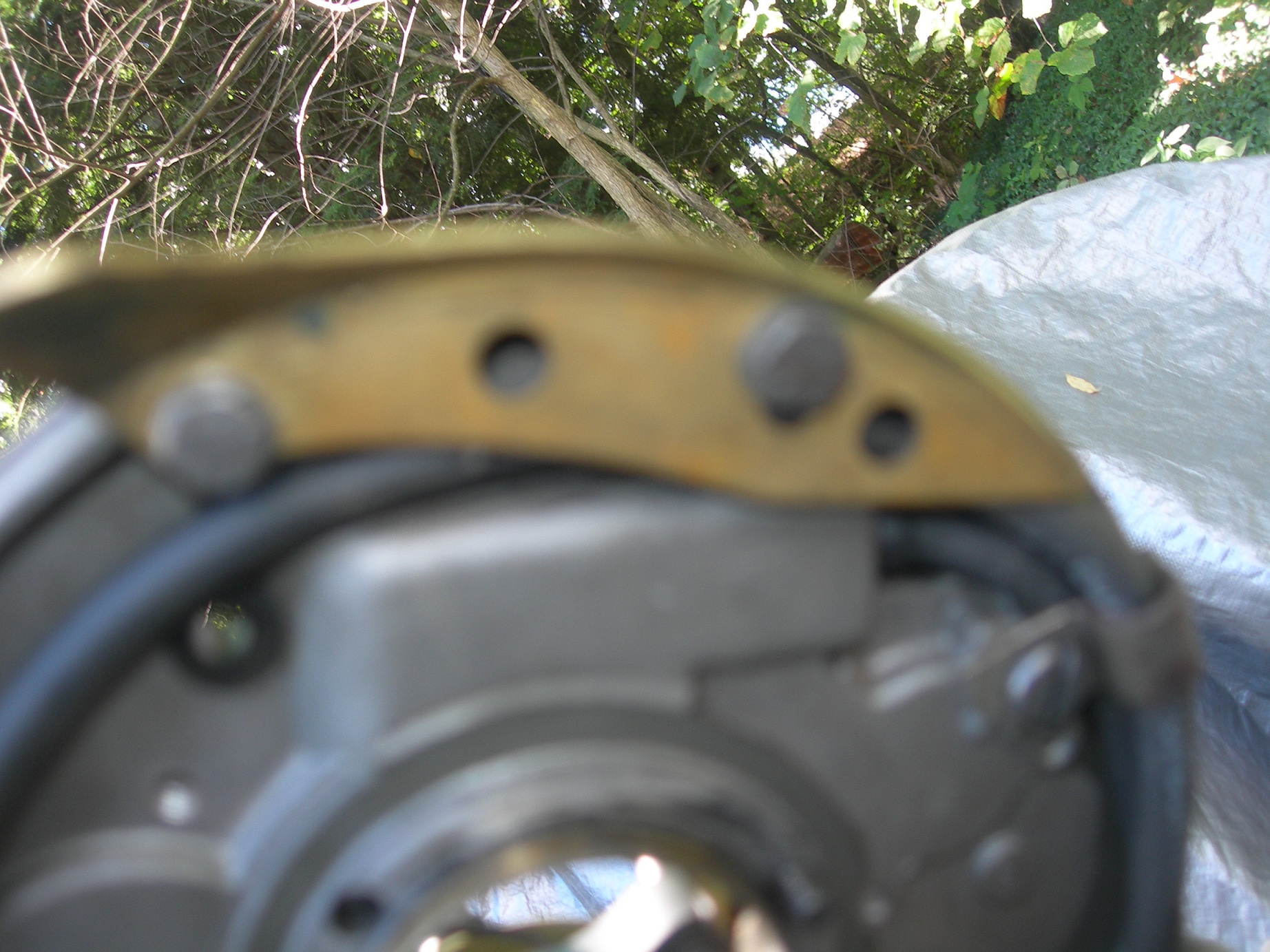

I am now officially out of ideas. I removed the carb again and purchased a rebuild kit. Cleaned everything really well(again) and replaced the needle/seat/spring/float and pin/welch plug,all packing/washers in high speed nozzle and low speed needle. Verified float level and drop etc.
It will still not idle below say 2-3k rpm. It has to be the timing/synch. All of the manuals I have say that it should be adjusted so that the cam roller just engages the throttle when it is between the two marks on the throttle cam. Well...it is engaging the throttle already as I have to move it to lower the armature plate back onto the flywheel. By the time it gets to the marks the throttle is 1/2-3/4 open. I can only see one place to adjust. There is no way to adjust the throttle arm or Cam Roller arm. Only place is a screw on the cam where it connects it to the armature plate and I have it set in as far as it will go as you can see here in this blurry picture:
Also notice in this picture that the cam roller has a line lower on it that indicates that it at one time was riding much higher on the cam.
