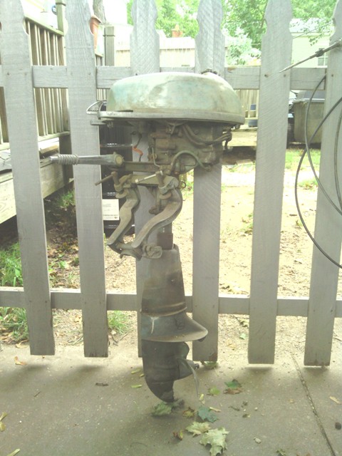

Anyone know what year and HP this Johnson might be?

Try again

looks like an early 50s 5 hp, dime a dozen around here.
Re:johnson id 14 years 2 months ago #67757
Looks like a TD 20 , 5hp. Ebay is filled with them, or craigs list.It could be a 3 1/2 hp model also. The lower cowl is missing.Really cheap little motor and they run surprisingly good. No neutral on these, so pull and go. Built from the mid 40's to around 50ish.
Re:johnson id 14 years 2 months ago #67780
It is indeed a Johnson TD-20. Model number will be stamped in the cylinder block, port side, near the seam between the block and exhaust housing. They are one of the more common vintage motors, which is great for parts availability - lots of parts motors out there. Yours has the look of a parts motor. Missing grip, cowling, recoil, etc. Unless the powerhead has great compression and no wear on the center main, I'd look for another one and use this one for parts.

Thanks for the info.
A co-worker was taking it to be scrapped. His step dad gave it to him and said it is a runner but my co-worker is not interested in boating..He gave it to me for free.

Hey get it running and it will make a nice kicker motor. The old they are the better I love them. To take a motor thats been sitting for 20 to 40 year and hear it come back to life is something to hear.
