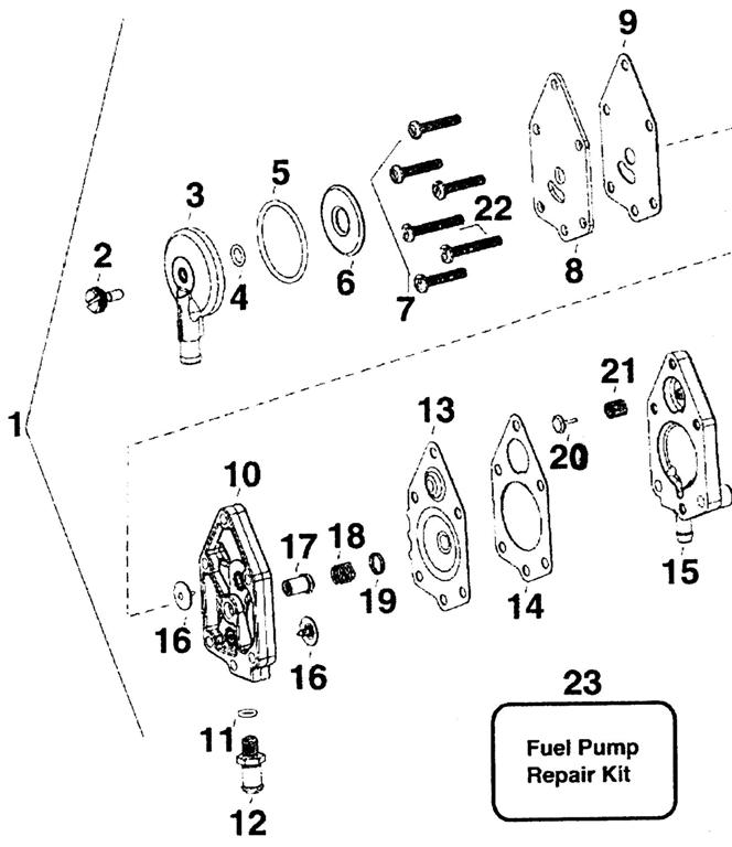

I just got the 120hp 1990 evinrude rigged. I thought that the fuel delivery (pump) wasn't working right and was starving at high idle. I then took it to the lake and ran it on the trailer putting in and out of gear. It seemed like it was running OK. Then I took it out on the water. Again, it was running pretty well until it died right when I was turning around to head back to the launch ramp. The other problem is that I can only find VRO fuel/oil pumps. My mechanic says that I don't have VRO and my pump looks different. I removed it and found 438287 and 25-F-1G below it on a white label. I just can't find it anwhere on the web. See why I'm puzzled?
Re: Fuel pump puzzle... 14 years 3 months ago #65821
Got a pic of the pump in question?
Re:Fuel pump puzzle... 14 years 3 months ago #65823
Does it look like this?
Re: Fuel pump puzzle... 14 years 3 months ago #65840
You can see it in this link as the updated version of part number 438287. I am oretty sure that this is the problem. Now it only fires when I prime the carbs with a shot of premix. Phil

Okay, that number supersedes to 5007422. That's a VRO2 replacement kit that does away with the VRO pump. The "tech info" supplied does mention a "pulse line";
www.marineengine.com/newparts/part_details.php?pnum=OMC5007422&ptype=&Engine=&Model=
Here's the tech info that goes along with the kit;
www.marineengine.com/parts/technical_information/omc_5007422.pdf
