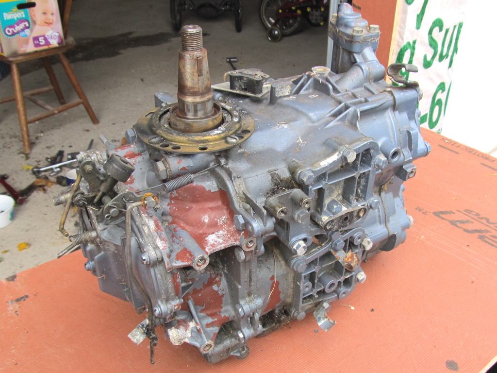

I have a complete 40 hp Evinrude shortblock powerhead that would bolt right up for you if you want to breathe some life back into your back-up motor... It has about 95 psi in both cylinders. Let me know if interested...

Thanks Scott,but I have a v-4 75hp. If you have a good one,I might be interested later. jim
Re:Water choke issue 14 years 3 months ago #65724
Doh! Sorry - I've had Big Twins on the brain of late. Picked up three of them over the weekend... Saw your hotwater choke issue and immediately thought of the twin first...
