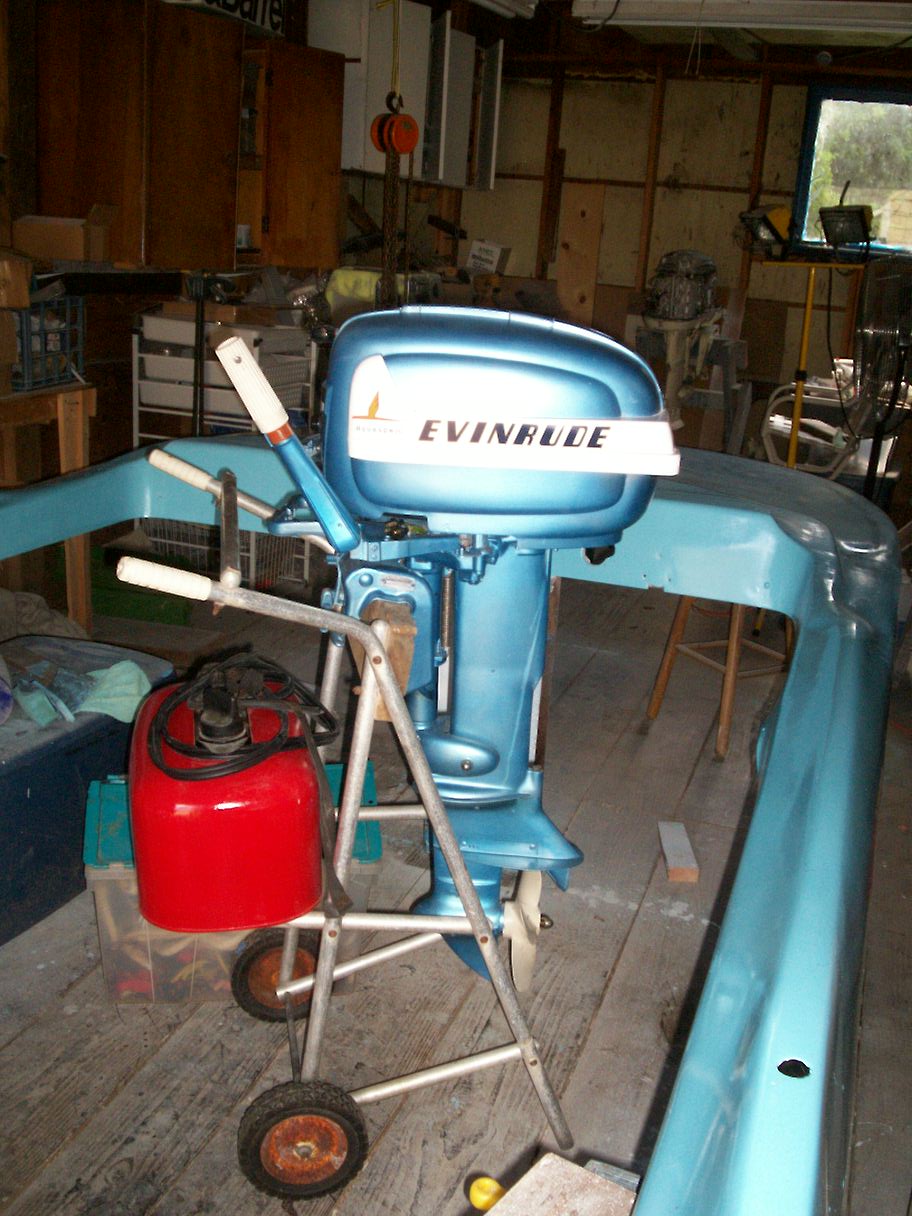

I have a very nice 1955 Evinrude 15hp. I redid the carb, lower unit etc. Painted it. Problem is the compression is very strong and makes it very difficult to pull the start cord. Any suggestions or do I just have to live with it. Thanks, Mike
Re:1955 evinrude compression 16 years 5 months ago #6562
Start lifting some weights! Not much you can do about having TOO MUCH compression. That's actually a good thing, as most folks with 50+ year old motors are dealing with TOO LITTLE...
- Scott

Roger that Chinewalker!! I'm 71 yrs young and splitting my wood for next winter so should be ready to rock and roll! LOL. Mike
Re:1955 evinrude compression 16 years 5 months ago #6569
Your motor looks great! I've got a fairly clean one myself. Good runners...

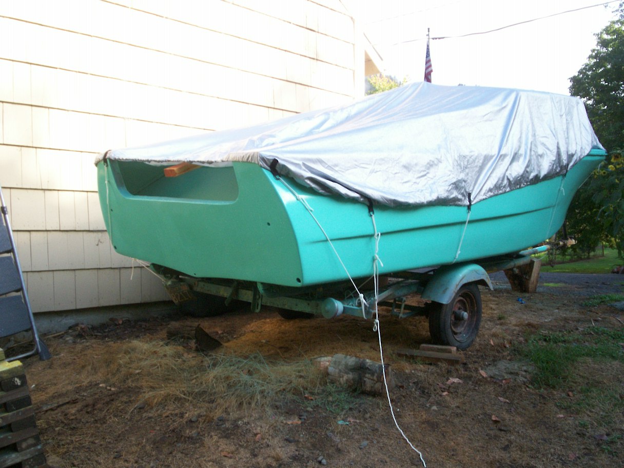

Beautiful vintage 'Rude, Mike! Going to use it as a kicker on the Monterey, or is that another project in the works? Would love to see some more pics of the Dorsett, when you get a break from cutting firewood. ;) Old guys RULE!

More pics of the Dorsett as requested. Enjoy.
ps I have a golden jubilee lark ready to go for the Dorsett.
