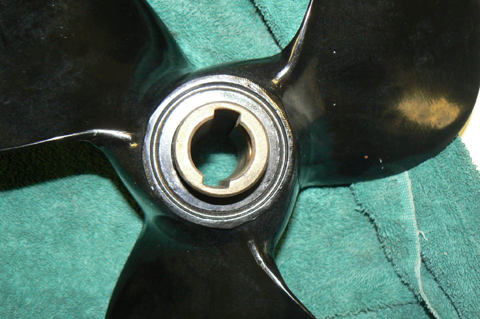

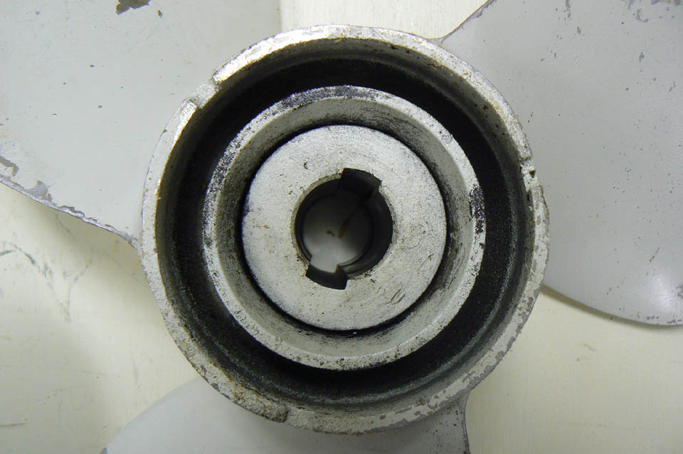

Ok so here are some pics. The first two are the front of the props, new (black) and old (white). Look ok to me same orientation from the looks of it.

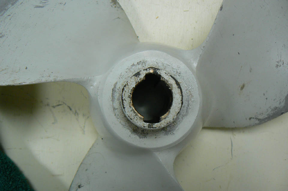

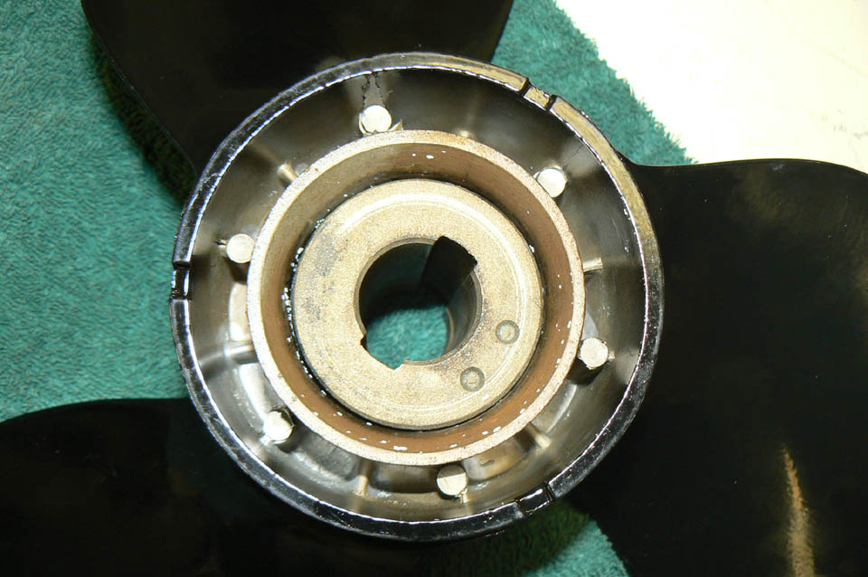

Now here they are from the back. Look a little different orientation wise but don't know if any tabs are suppose to line up with any notches or not.
So from what I can tell it's fine. Tried to turn the inner hub with channel locks just to see and wouldn't budge. I was king of hoping that was it, would suck sicne it's a enw prop with one 3/4 day usage but at least I would know it wasn't something in the nlower unit. Now I'm not sure what to think.

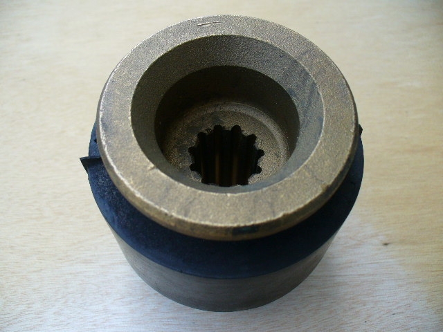

Re:'59 Fat Fifty possible lower unit issue 14 years 3 months ago #65369
Hi Bob,

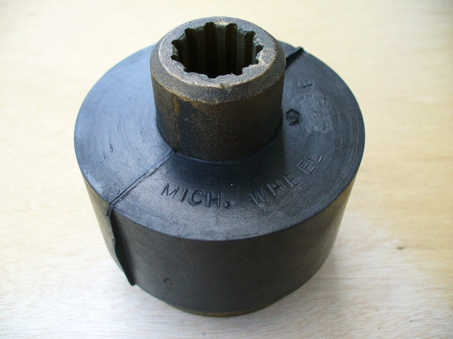

The rubber portion cannot really be seen once it is installed into the propeller casting (if in good condition). Although it is for a Mercury application, I am enclosing a picture of a hub assembly.
In the picture of your "new" propeller, is there any rubber showing (there looks like there may be)? As Bruce states, the hub would be quite bad to slip with the use of simple tools, as they will usually only slip with the load of pushing the boat.

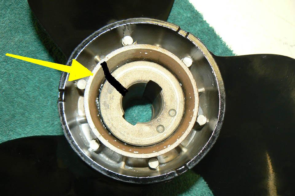

Take a laundry marker and draw a line from the hub to the bore of the prop. Let it dry. Re mount the prop & try the engine to see if the problem comes up again. If it does, remove the prop & see if the lines still are in the same place. If not, the hub is slipping.

Thanks gentlemen, well marked the prop, put it back on and went to the ramp. Started the motor, lever was in neutral but lower unit wasn't! Thank god it was at idle. The damn thing was in reverse and stayed there when I shifted to neutral and forward. Took her back home and sure enough, took the shifter linkage access covers off and what did I find? Damn lower shift rod was out!!!!!!!!!!! Well that explains why she went into uncontrolled neutral twice and I could still limp back home. Caught just enough to get into forward. Also explains why it stuck in reverse after I tried shifting it a few times after getting home Sunday.
Removed the lower bolt, reconnected the rod and tightened back up. Should be good to go now for the rememberance run next weekend. Can't run her this weekend, have to move the daughter. Glad to no I didn't piss away money on a new prop, only to have spun it! Still keeping the old one on board as a precaution.

Probally another 'correct me if I'm wrong' question. Reading through this post I cam to the spun hub replies. In the first pistures he shows a pin prop, in the answer by Ferguson Poole the pictures are of a splined prop. I thought the protection for a pin prop was the pin. Am I wrong for thinking that a pin drive prop also has a rubber bushing that might spin if the pin does not shear??
Re:'59 Fat Fifty possible lower unit issue UPDATE 14 years 1 month ago #69325
yes a pin prop has a rubber bushing. Now I have taken a spun prop and drilled down between each blade into the hub and then taped each hole and run a screw all the way into the hup. It works but not the right way to fix it. But sometimes you just don't have the money to fix it or buy a new prop.
