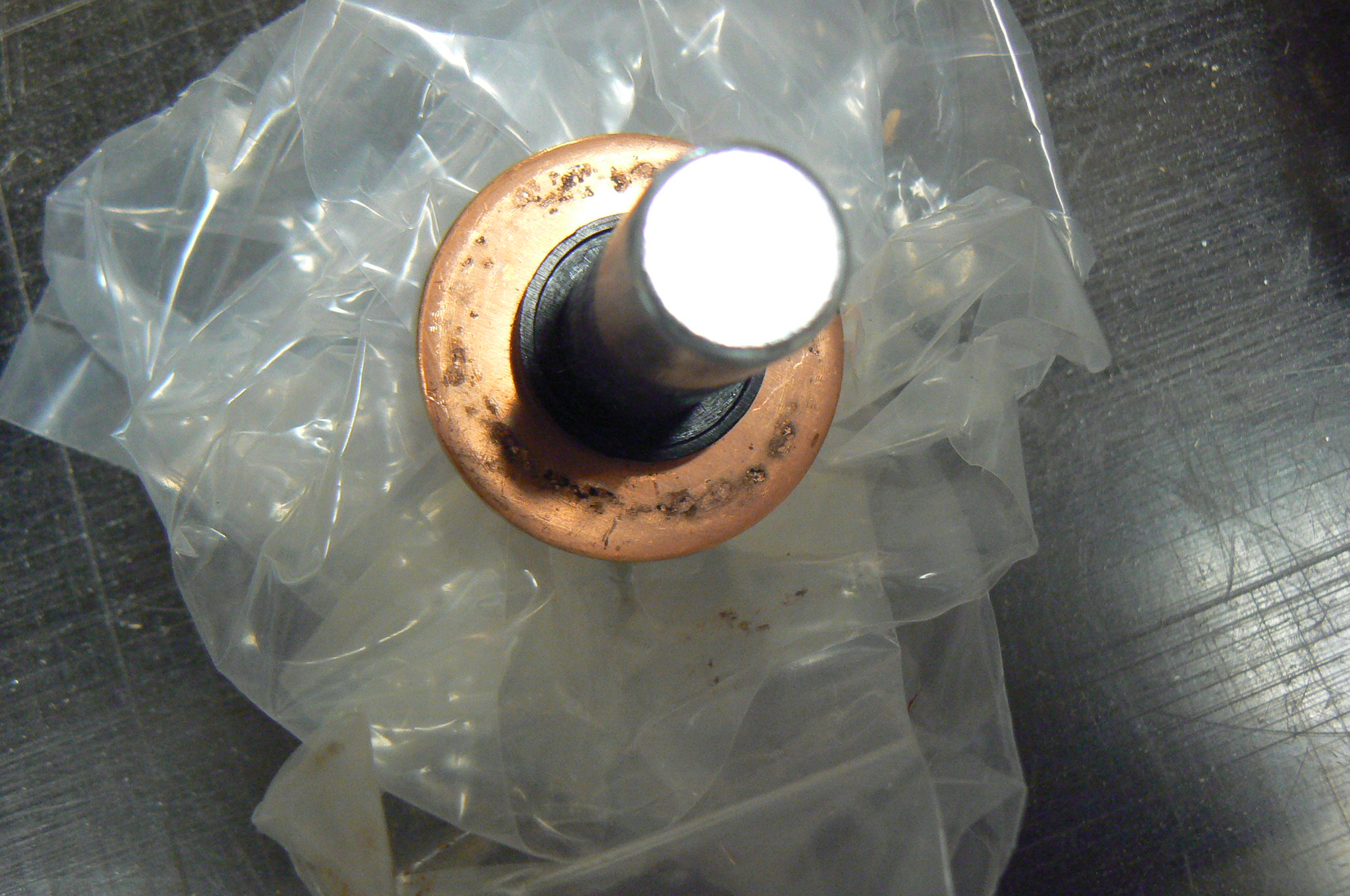

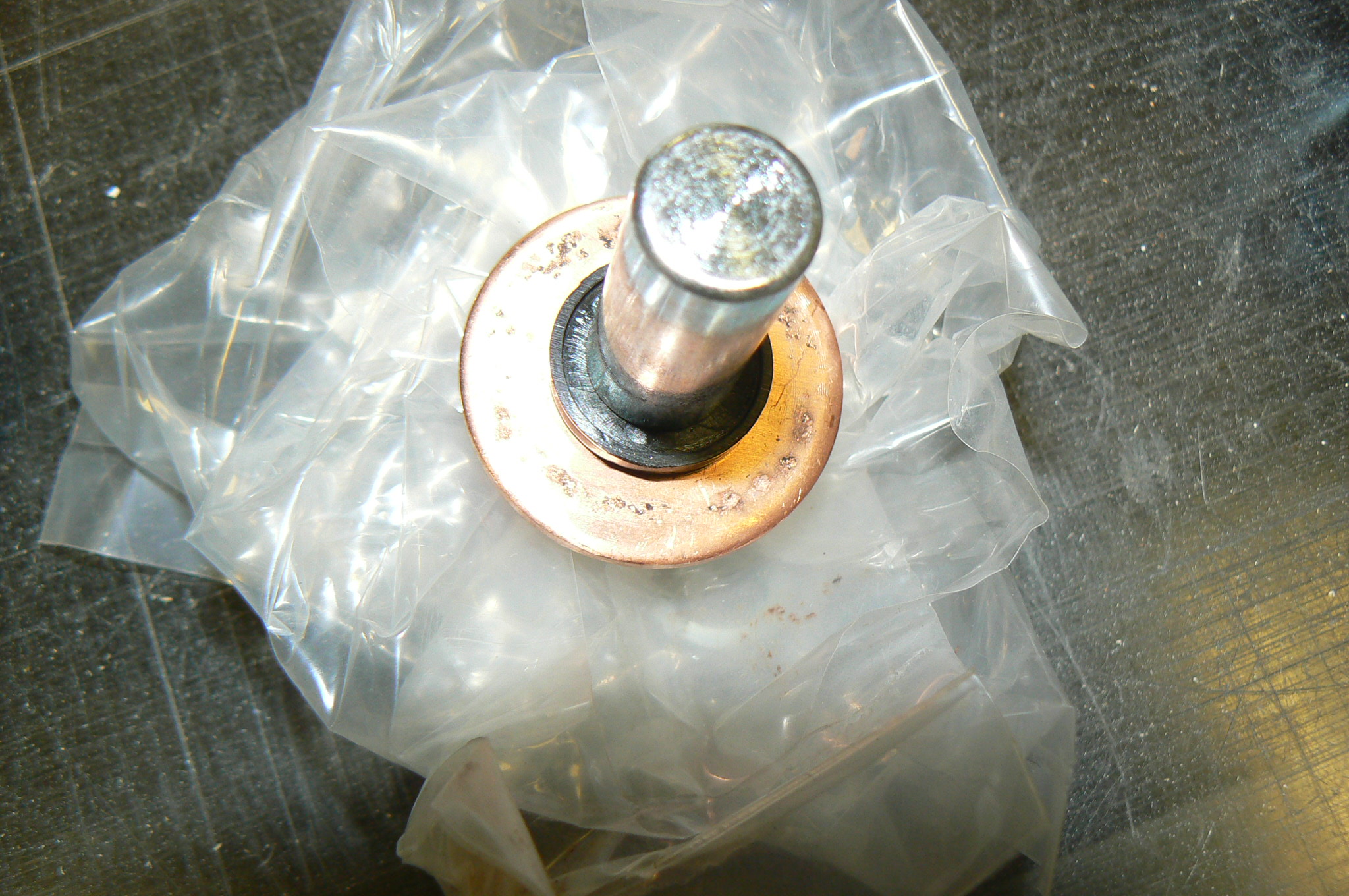

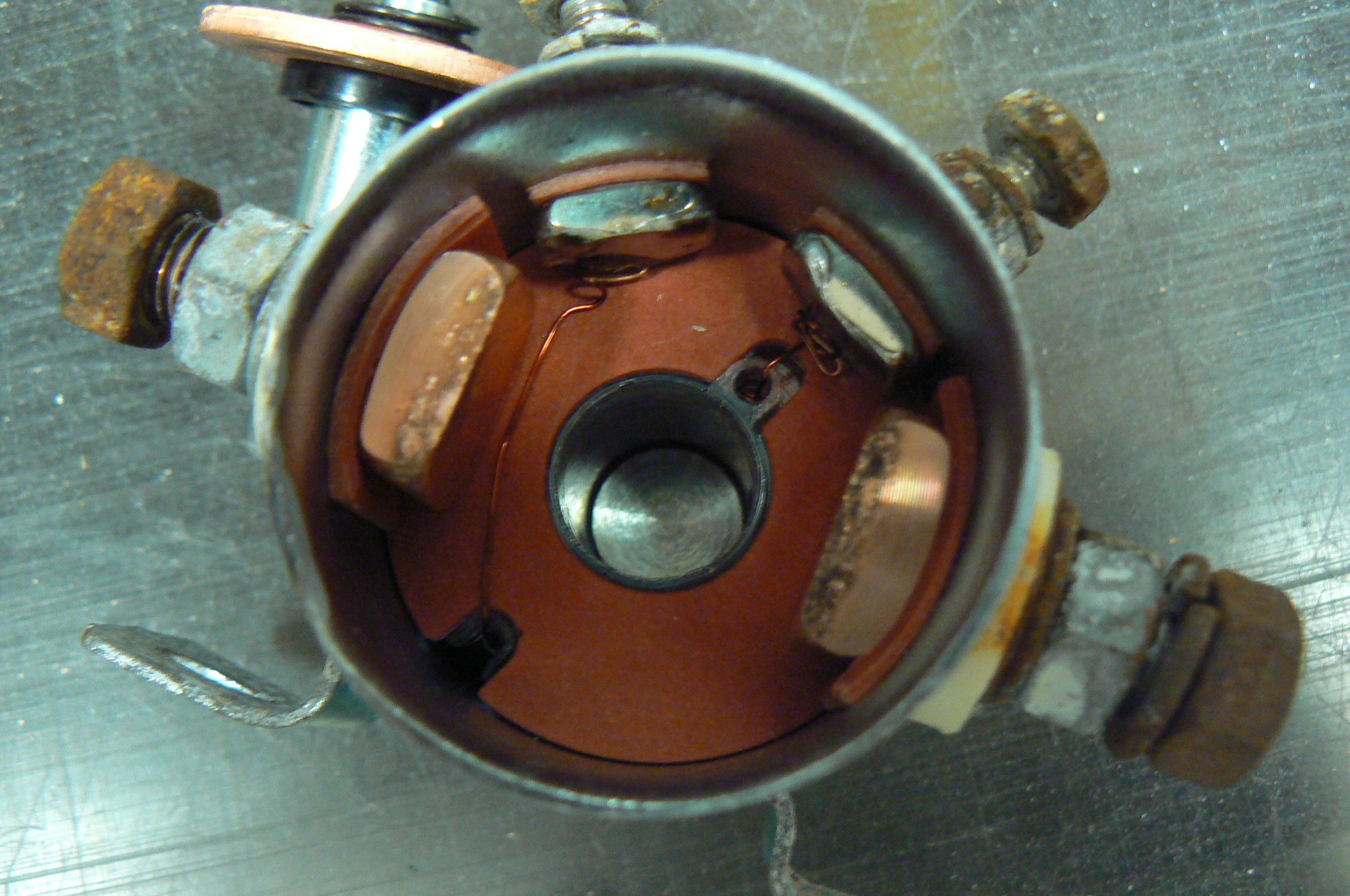

Re:'59 Fat Fifty Starting problems Update! 14 years 1 month ago #69834
  • Waterwings
  • Waterwings's Avatar Topic Author
  • Posts: 4902
  • Karma: 107
  • Thank you received: 100
Well I took apart one of the sticky solenoids and here is what I found.
So any ideas?
Re:'59 Fat Fifty Starting problems Update! 14 years 1 month ago #69846
Bob, it's a tuffie.
Am I right in assuming this is the solonoid that is in the starter box? Your connections look somewhat dirty and rusty other than that she looks pretty clean inside. Have you tried starting the motor by jumping directly to the starter motor from the battery when the problem begins, (hate to use the word "start")using jumper cables? That would narrow the issue to the start circuit only. Is there a diode in there somewhere? If the solonoid is clicking then it's working and the problem is somewhere else.
You might try going to Napa or some other auto store and picking up another solonoid, Ford or something like that. They are for all practicality just a big magnet relay to save your key switch. I'll try googling around for some answers although I'm sure you already did that.
Cal
