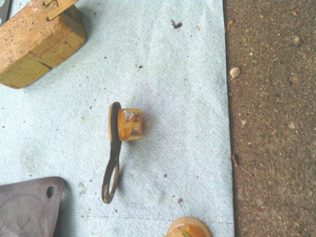

Testing pic upload.
The check valve in fuel pump popped again. I'm pretty sure it is a problem.

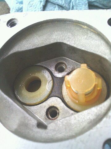

Testing pics again.
By the way...arrow is the correct way and float level is good.
I'm pretty sure the check valve is the problem since it's messed up again.

Another pic

I was hoping i could get a confirmation that this is "most likely" my concern. It seems like the fuel would be pushed towards carb then pulled back through the open check valve by the action of the diaphragm and not reach the carb like it's supposed to correct?
Does any one think pumping the prime bulb could pop the valve? The valve does not look worn out and it takes a decent amount of force to pop it open like in the pic. Or...could it be something with the motor itself. Or...am i dealing with a rare situation that no one has an answer to, LOL?
1960 slickcraft catalina
1963 g-w invader ski-bird
Portage Michigan
Re:evinrude starflite fat 50 fuel problem 14 years 3 months ago #65228
No way that valve is going to work. When the kit arrives, just install the parts & it will likely solve the problem for good.

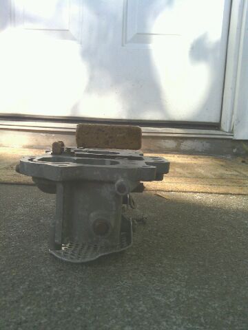

Below is a pic of float level...float is new. Slow speed needles at 1 1/2 turns out and high speed at 3/4 turns out.
