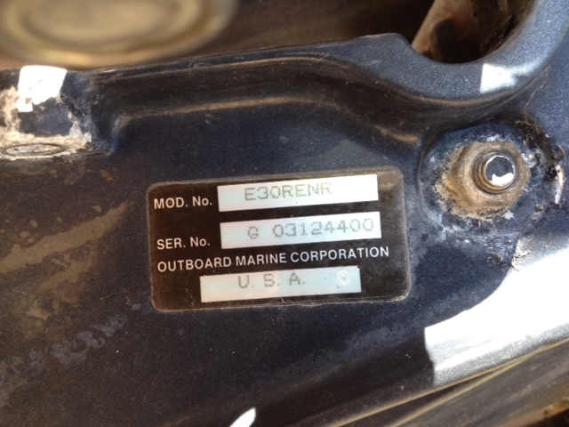

Re:30hp evinrude 14 years 4 months ago #63200
  • riceman
  • riceman's Avatar
  • Posts: 397
  • Karma: 12
e = Evinrude
30 = 30 HP
r = Rope Start
e = This is supposed to be shaft length. didn't see a length for "E" there's designations for a blank spot, L, Y, X, and Z
nr = this is supposed to be the year. this model number system was 1980 and up, so NR = 1924 makes no sense.
if instead the model number was e30r_enr, then it would be and evinrude, 30hp rope start with 15" shaft from 1992 with an "R" suffix.
marineengine.com has all the info i've mentioned here. go to look up evinrude outboard parts and over on the right side you'll see a link for look up by model number.
as far as swapping it over to remote contols, it should be straight forward. some pics will help get specific instruction.

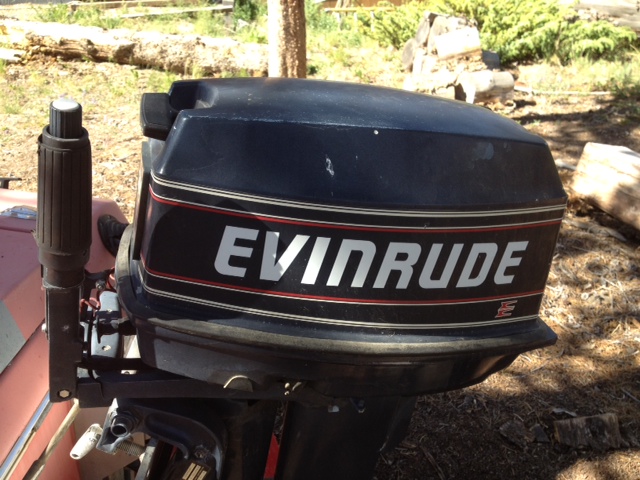

as promised, the pictures !
Re:30hp evinrude 14 years 4 months ago #63236
1993...

Re:30hp evinrude 14 years 4 months ago #63256
2 stroke Oil injected.....if you trust them

Re:30hp evinrude 14 years 4 months ago #63298
If it was me (because I had a system fail offshore) I would mix the oil in the tank at a 50 to 1 and forget the oil injector system

Re:30hp evinrude 14 years 4 months ago #63320
The 30 HP was not a VRO, you need to premix at 50:1
