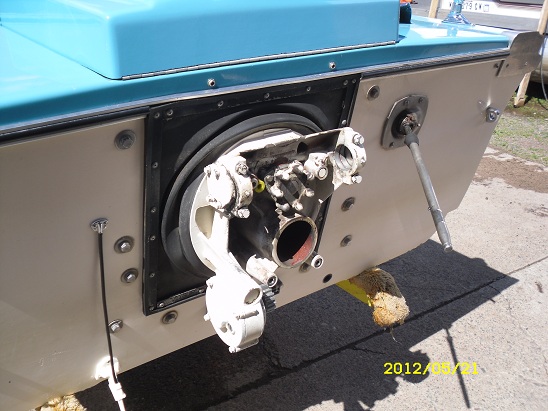

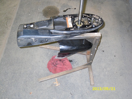

My turn to brag about the day's work.
Picture 1, pressure washing the intermediate housing after removing the ball gear shaft to grease the splines.

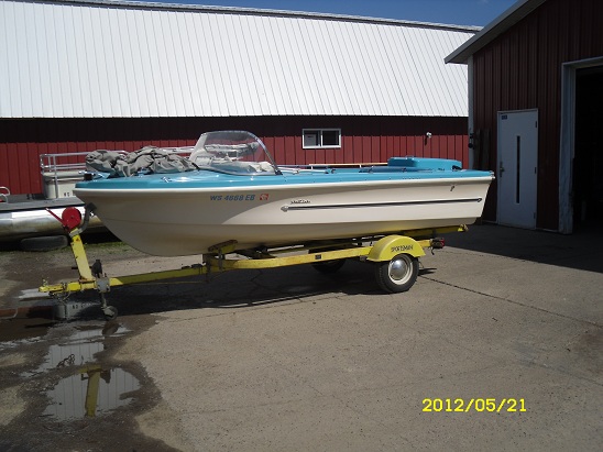

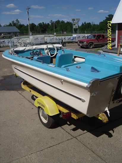

Pictures 2 & 3, the drive after replacing the oil seal on the ball gear shaft & pressure washing drive.
Pictures 3 & 4, the boat the drive fits.

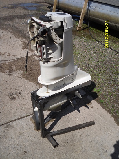

Picture 5, resealing a Merc 60 & found the water pump seal housing broken, waiting for part.

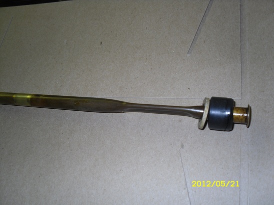

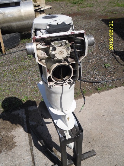

Picture 6 & 7, 09 Merc 25 4 stroke that won't pump water. Pulled tower housing & found copper water pump tube crushed. I can only assume that trapped water froze in the tower housing & crushed the tube instead of cracking the housing. Waiting for part.

I didn't "thin the herd" at all. I won't attempt to sell one at the store, my customers want to cut the bow open & make an open bow.
Peter Switzer (Bob & Carol's son) did make an open ended offer on the Switzer Craft. I haven't decided what to do about it.
The Shell Lake hasn't been in the water since '08 or '09, I can't remember but the stickers are expired. I've decided to run it a bit this year, so that's why it's out of the shed & here instead. I just need to hang the drive, put a battery & fuel in & hope it will start.
