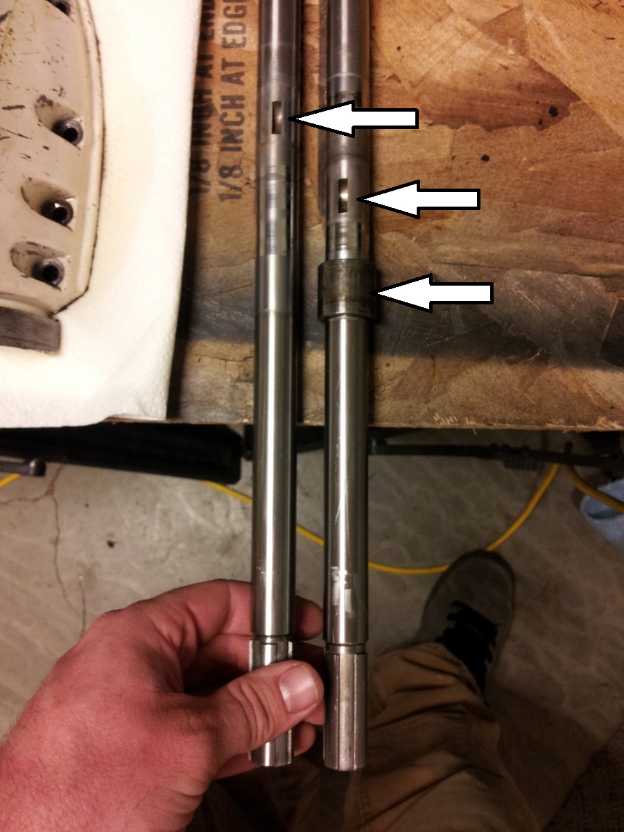

so i grabbed the SS diveshaft and figured i would do a side-by-side comparison and see if the only difference was 5" in length. well, they're 6 3/8" different in length, and i found these differences (the one on the left is from the 50):
the splines on both ends appear to be the same. the keyways are the same size, but in different locations. there's also the steel bushing that rides inside of bearings that don't exist on the 50. looks like i can't use the 50 driveshaft on the 60 LU. i'll have to find a driveshaft from a LS 60 if there's any chance of this swap working, unless y'all see something that i'm not.
