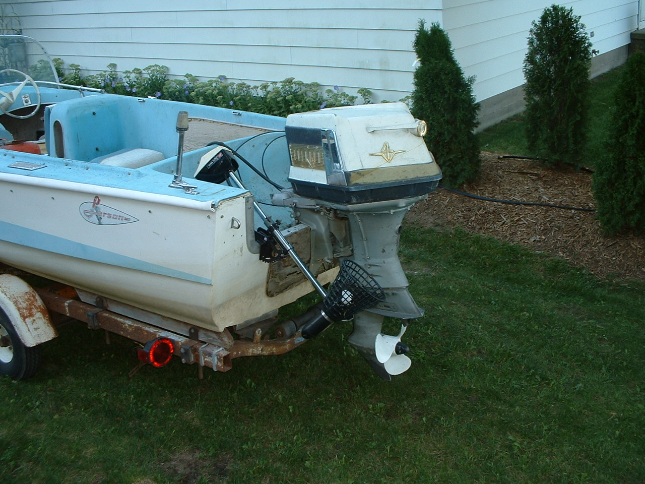

Went to fire up the Fat Fifty (59). Only have spark on the starboard side. Points? It has 2 sets in the Magnito (sp) :angry:
