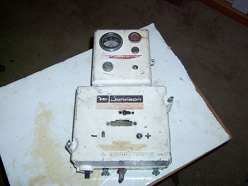

Here's an OMC electric start box assy on ebay and it looks like it's wired up with a voltage regulator as well.
The panel mounted to the box is something I've never seen before, with built-in ign switch, ammeter, what looks like a red "ON" light and a hole where perhaps the choke used to mount.
Might be something you can use.
HTH...........ed
