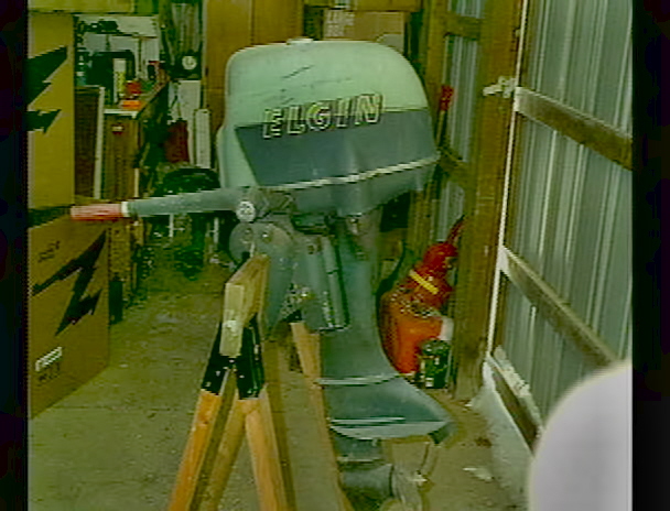

Re:How are Chrylser's outboards? 14 years 7 months ago #58349
Chrylser bought out West Bend. They were dependable motors.
In there day if properly maintained.
Sears sold under the Elgin name before they went to Scott McCulloch This is my 54 16hp Elgin

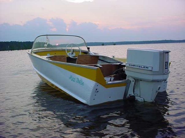

I love my chryslers.. Lightweight, simple design, most maintenance parts can be bought at NAPA.

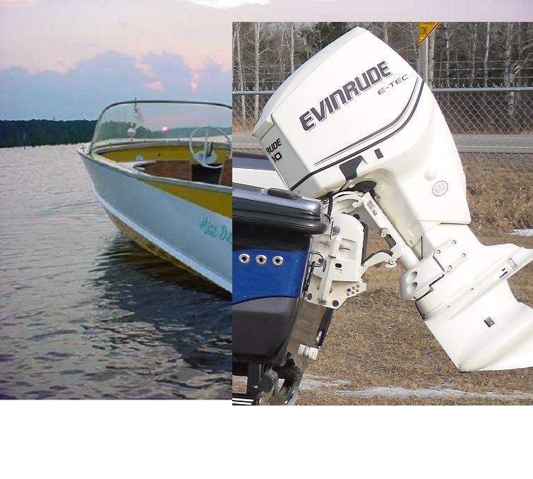

You meant Evinrudes????
Re:How are Chrylser's outboards? 14 years 7 months ago #58385
Eeekkkk!!!
Re:How are Chrylser's outboards? 14 years 7 months ago #58398
  • Kerry
  • Posts: 675
  • Karma: 51
classicfins wrote:
Eeekkkk!!!
You need SpellChecker- its spelled E-TEC. :lol:
