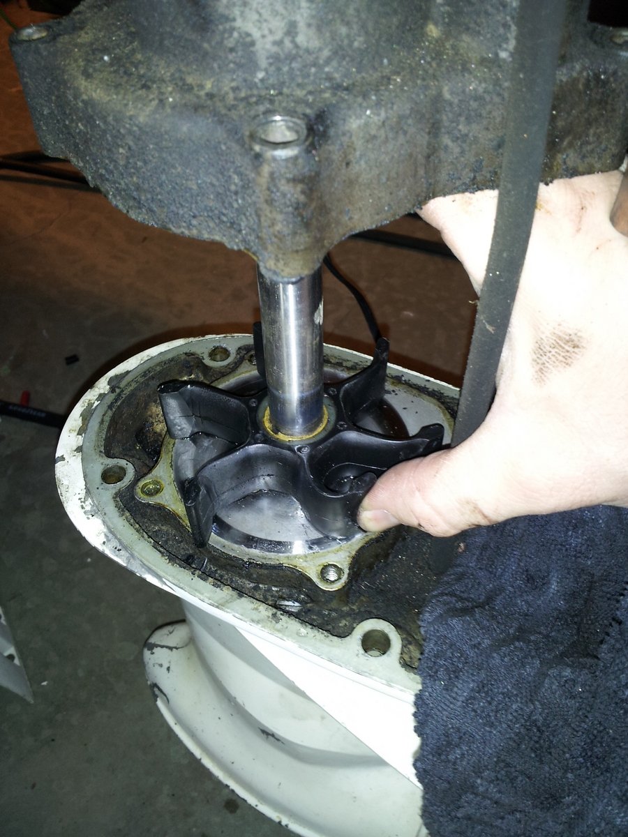

got the waterpump out. it looks like it was changed real recently. at least to my untrained eye, anyway. also, you guys weren't kidding about the removing the bolt thing. for some reason i swore i thought i remembered someone saying DON'T remove the bolt, and off i went. after 15 minutes of being fed-up, i finally removed the bolt. it then dropped out no problem. boogered up the bolt though. good thing i got a spare i suppose. oh well, live and learn. anyway, here's a pic of the waterpump. please tell me what you think!

Even though your impeller doesn't look bad, I would put a new one in there if it were me Riceman. You're right, it appears to have very little wear on the vanes, but it's as much about the age of the rubber as it is the wear factor. They really need to be changed out every couple of years, and since you have it apart anyway why not put a fresh one in?
It's my understanding that if the vanes don't return to a "straight" position several hours after being removed, it's time to replace. Yours appear to have taken a slight "set" to the curved side.
Also I would inspect the inside of the housing (known as the cup?) for wear grooves. Anything you can catch your fingernail in would indicate need for attention. Any seals should be inspected and replaced (if questionable) as well, IMHO. You've got the hard part done, (getting it apart), why not go ahead and service everything while you're in there?

From the pix of the impeller it has taken a set. That is the blades are bent a new impeller they are stright. If that is all you need you can get them at NAPA auto parts for $20 or so. You will most likely have to order it and if in wearhouse it will be there the next day. If you have a bunch of parts to order try Seirra Marine.
