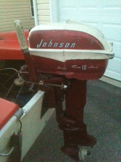

Hi All, just picked up this QD-18 serial #1544XXX. Andreas tells me its a 1957. The PO didn't have a pressurized gas can so I didn't get a chance to see it run but he assured me that it did. He also changed the plugs, lubed the LU, etc. Can anyone tell me anything about it? Thanks in advance.

Re:Johnson QD-18 14 years 7 months ago #57256
A QD-18 is a 1957 10 hp..What more do you need to know. I can tell you a lot, however you may already know it

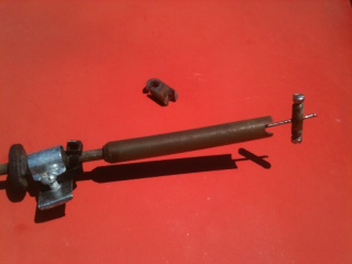

Hi All,
2 more things. What kind of compression should I be looking for with this motor? The compression meter that I have is the kind with the hard rubber on the end and as tight as I can hold it with 1 hand and pull on the pull start with the other I am only getting about 60 psi(?). Is that way too low for a 10hp engine or am I okay with that? Second thing as you can see in the pix the plastic end of the shift cable broke off thank God while the boat was sittin' in the field and not coming up to the dock. Question is if I were to get new cables that are longer than the ones I have now can they be shortened or do I just need to coil them up somehow? The shift cable on there now is about 11' long and the throttle cable is about 12' long. Again, thanks in advance.

Re:Johnson QD-18 14 years 6 months ago #60471
  • F_R
  • Posts: 12
  • Karma: 1
That cable guide is part number 381444 with the push pin, or 385956 for the guide alone. It does not come with a new cable. It is available from any Evinrude dealer, or anyplace selling OEM parts.
As for cables, they come in one foot increments, so order the correct size. Trying to use ones too long or too short makes them very stiff and hard to work. Again, any Evinrude dealer or for that matter, any marine dealer can get you Teleflex cables. They are Teleflex' "Type 400" cables.
