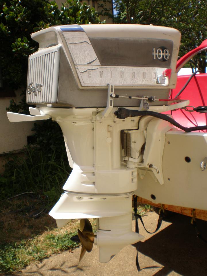

Looks pretty don't it? I never liked the gray paint on the lower part of the fat fifty. I used GM "fleet white" from Dupont's Nasson line. Tucked neatly under the hood is a 1967 Starflite 100. 14 pitch bronze michigan prop, the motor loafs along at 3,000 rpm at 30 mph.

Sweet Bruce!!!!!!!!!!! So that's the '67 100 powerheqd on the Fat Fifty lower? I like it!!!!!!!!!!!!! I'm thinking of re-skinning the '67 80 in the '62 housing. The mounting bracket housing on the '67 is very stiff and the '62 housing tilts very easy. Paint it all up in the '62 colors then looks closer to original for the '60 Clipper if I need to put it on, if the Fat Fifty doesn't work out after moding the pistons.

Looks awesome! I have 2 '67 100 hp OMC's that I am going to transplant to a '58 Fat Fifty and '60 Starflite chasis. I am thinking it would be much simpler to just switch the pans and hoods from the earlier motors to the 100 hp chasis. Is this possible?

Yes, swapping pans is the best way to accoumplish the "look" you are after. The engine pictured have lower portions are from a 1960 Gale. The Fat 50 had a weak transom mounting and it isn't a good idea to put more power on a 50 lower unit. The hood & bottom pan is all that I ever save from a 50. All the rest gets scrapped. The wiring harness and the linkages to the throttle can present a bit of a trouble spot on a swap over. Also, the clearance to the carburator is very tight. I modified the needle valves on the carburator on this one to clear the hood. When you get ready to do the swap I can give more detail.

Thanks for the reply. Forgot to mention I also have a Gale V4 60 hp that will be getting a '66 80 hp powerhead, or a pan/hood exchange. I just love the look of the '58-'60 OMC hoods.
I would appreciate the advice when I get started. I'll also have some questions about the '60s hydraulic tilt feature. I have one but need a new cylinder for it.

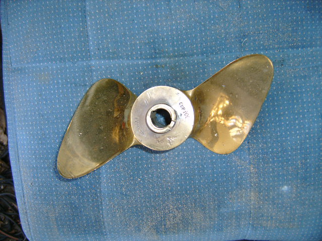

I just happen to have a "HOT" prop for these old motors. a 16p CUP Michigan, needs a very light load
