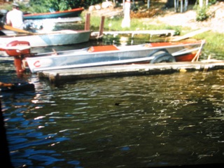

Thank you for the replies again and thank you chinewalker for the offer. After much research I have decided to try the newer number piston. There were two available on ebay for $12. ea plus shipping and several people assured me they would work. Wish me luck I will let you know how it turns out. This is the motor circa 1956 on the family Crestliner.
