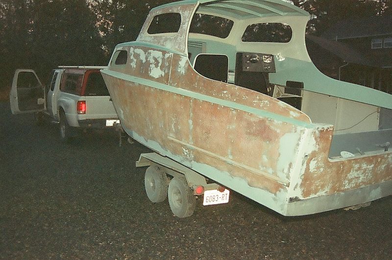

Thanks guys for all the responses. I believe the motors are short shafts,17-1/2" from the bottom of the transom clamp to the cavitation plate. Is this correct? Since the transom on the boat is also 17-1/2" the use of the remote motor board may be as Kerry mentioned, "Gives the prop(s) a better "bite" of water to push with. So, its a win/win." , since the boat was ordered with it.
The history on the boat and motors is that the owner took possession of the boat June 1959 and used it during summer vacations in '59,'60,'61 but then married and the wife was not into boating so the the boat went into dry storage for 42 yrs. The motors appear to have been in dry storage all their lives but I realize without proper maintenance during storage that rust/pitting would occur so it looks like I get to tear down my first outboard,oh joy. Luckily when I purchased the motors I ordered complete gasket sets along with new impellers but they didn't come with crank seals.I have fuel pump and carb kits on their way and will start my search for bearings/seals.Again thanks for the input and I'd appreciate any tips or words of wisdom before I tear into this project.

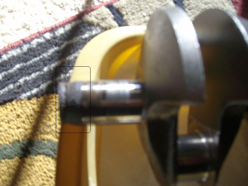

Tore down engine #1 today. Crank shaft journals/bearings are in great shape with no pitting or any roughness but may need to replace due to rust where a retaining clip at the rear of the crank used to be. The drive shaft stayed with the power head so it looks like I will need to tear into the lower unit as well according to everything I've read. Anyone have a good crank for 1959 RDS 21B Johnson PN #306252.
