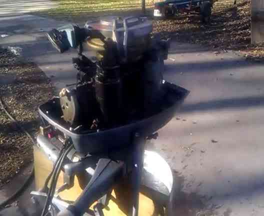

Heres the deal, I was previously looking to purchase an 18HP, but while going with a friend to purchase a trolling motor the guy he was buying it from had this 25 Evinrude in his garage. I asked him what the deal was, he said it runs but the starter stays on due to a PO hack job wiring. What would be a safe price to pay for it knowing hardly anything about it. Basically parts value, I'll at least try and run a compression check. It does shift forward and reverse but you can't really know 100% until it's in the water. I think it's about a 1975? Not sure, but here are all the pics I snapped of it. It's in really decent condition, tiller steer. I asked him how much and he said prolly $150, and his wife looked at him and said you dont need that S**t, give it to him for $100. So what do you guys think?

$100 I would be on that like a duck on a June bug

Well worth it at $100, especially with electric start.
The "haywired" solenoid should be easy enough to fix, big thing on these is worn-out clutch dog, if the lower unit is in good shape and doesn't jump out of gear, it alone is worth quite a bit more than the asking price.
If the compression is even, it's a true winner!

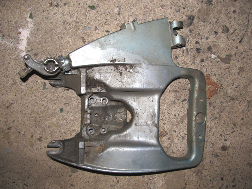

Is the tiller bracket broken? First photo it looks like there's some open metal on the starboard side - could just be a fluke of the photo?
In any case, an electric start 25 is well worth $100. The electric start bits work on a number of years of 18 to 25 horse models..
Only downside of the 1975 model is the low tension magneto. When they work, they work alright, but getting them set-up can be a pain at times. Not as good a system as the old magnetos (coils under flywheel) or the CDI ignitions that came afterwards...

Not a picture mistake, it is missing a bit of metal, when I inspected it, it didn't seem to affect anything TOO much, but I'm not sure 100%. Im going to try and talk him down to about $80 because he can't find the gas tank, and that piece of metal is missing.

If you do get it, I think I have the bracket for you...
