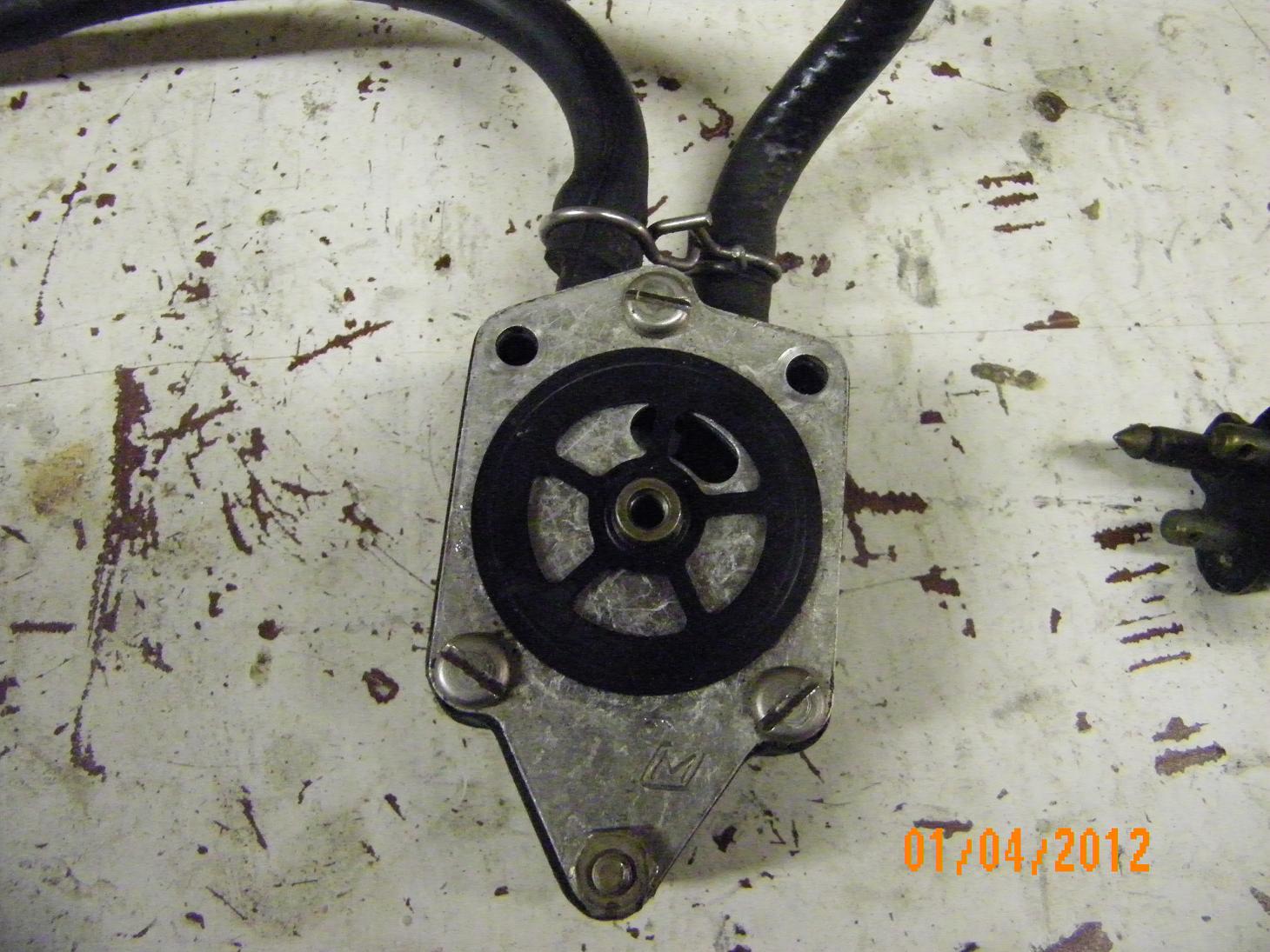

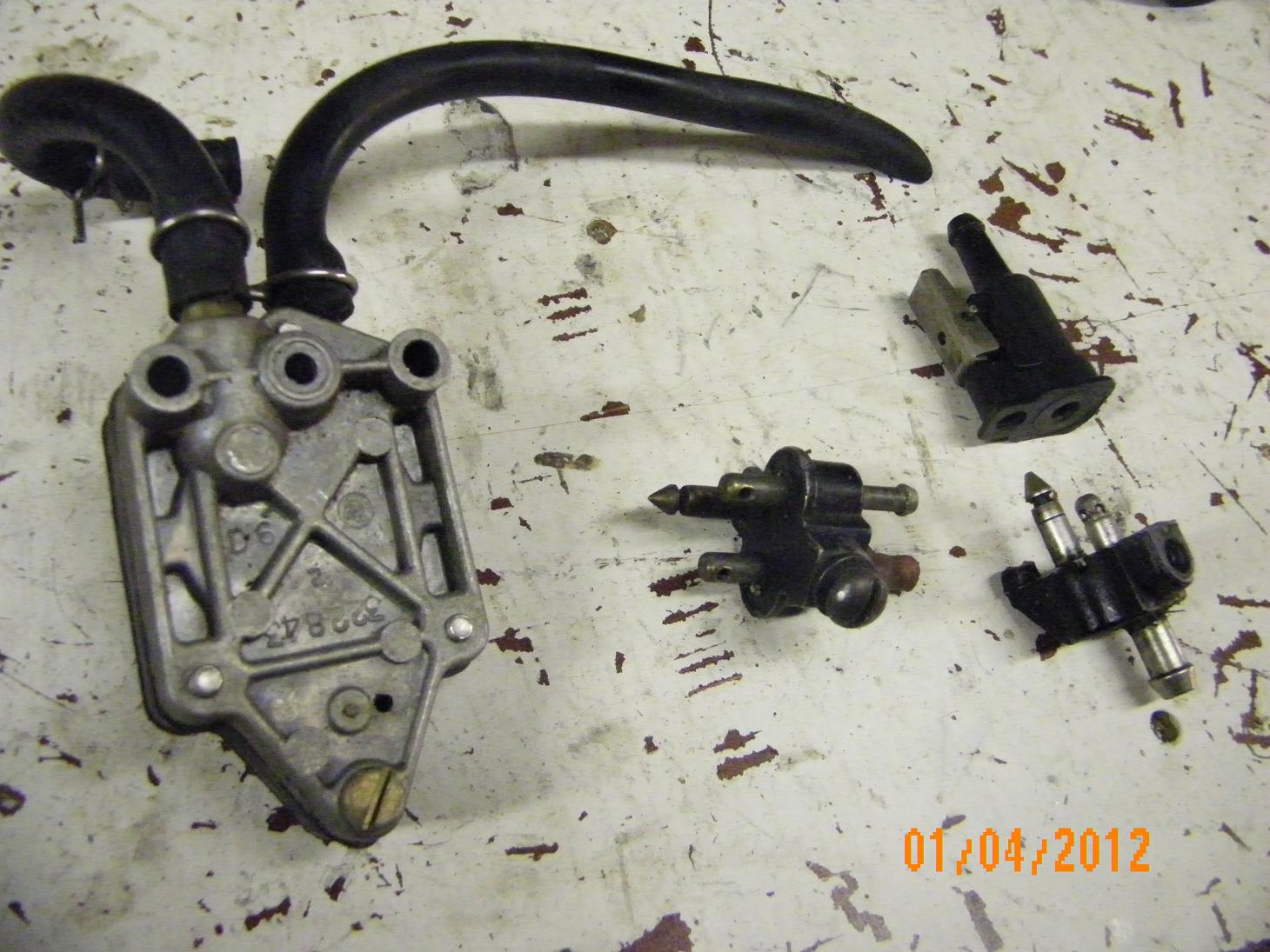

If anything in these two pictures interests you mail me. The pump I believe came off a Johnson 35, the tank and engine fittings came off a 35 big twin. Here is a link to a conversion to give you some hints. Hope it helps, good luck.
www.sschapterpsa.com/ramblings/Converting_dual_fuel_line.htm
