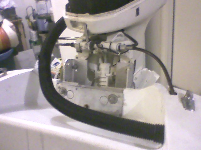

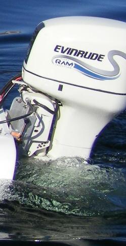

That's what my "gifted" mechanic said. But, he doesn't think it is hurt too bad by looking at the spark plug and it still runs. It's a 2000 Evinrude 150 direct injection that I have had for 5-years of blissful use. Should I tear it down and get the entire powerhead re-manned? Should I buy a working powerhead and swap it out? Should I sell the whole damn thing? Should I part it out until I have enough money to buy a different motor?
