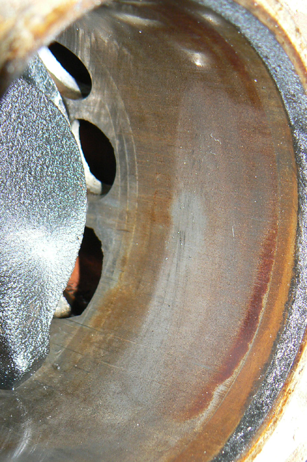

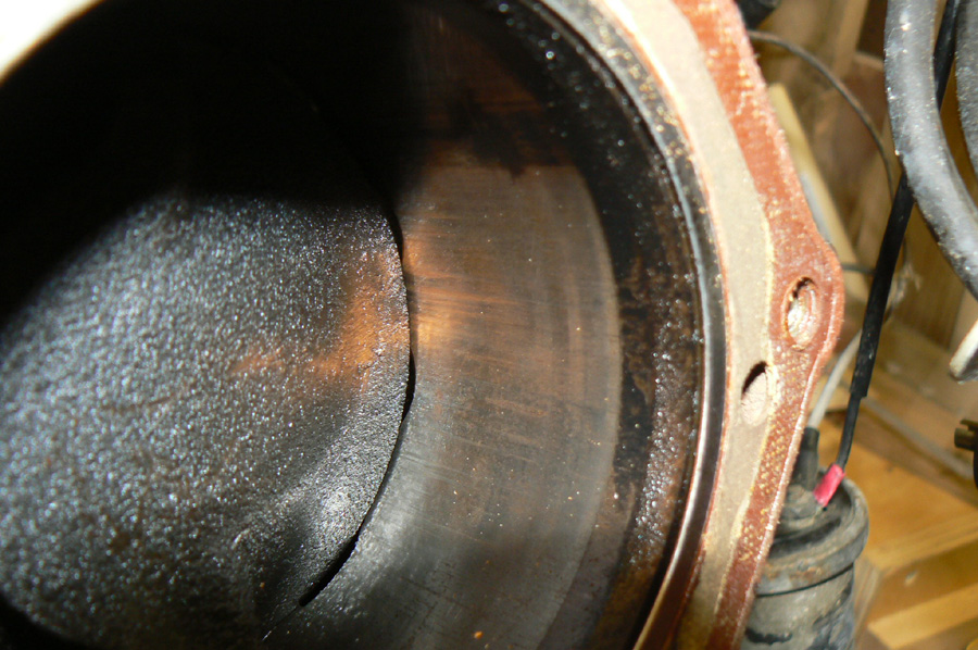

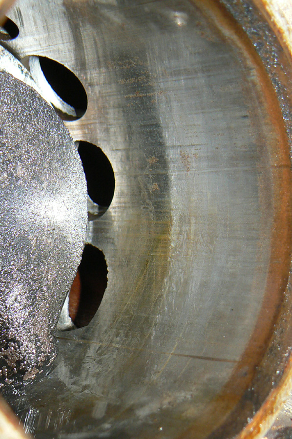

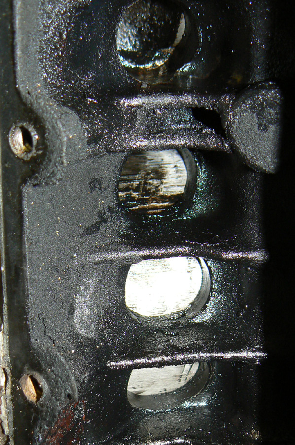

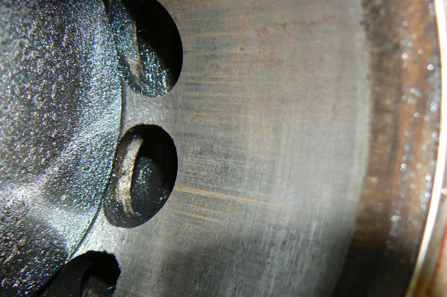

Pulled the heads and this is what I found:
#1 intake side
#3 intake side
#2 exhaust side
#4 exhaust side
#4 piston
Guess it's time to focus on the 80hp.
Re:1962 75hp questions 14 years 10 months ago #52345
No 2 has had water sitting in it. The scores on the piston skirt (exhaust side) are typical from what I have seen on motors with a lot of hours. That engine looks to have been used a lot, there is no remaining hone cross hatch, those bores are well glazed and galled. Just keep picking these up for real cheap ( like 50 bucks) and you will glean anough good pistons and a block that can be honed out. They are out there. Especially look for an engine that had a replacement power head from OMC. These are usually still primer red - that is the only color they were shipped in. The welch plug on the block water jacket will be stamped "RPH" with nothing else. These powerheads were NEW not rebuilt. I've found 2 of them in my search. Both were only lightly used and in great shape.
These engines were damaged by people using crappy motor oil, too much oil in the mix, and allowing the motor to lug. Use good quality TCW3 oil at 50:1, prop the engine so it will turn 4,500 - 5,500 at WOT with a light load. The rings will stay much more clean that way.
