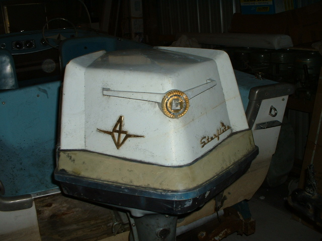

NOTE: a week ago i bought a 1967 Starflite 80 Electric Shift, that is "all in one piece" but that i know ZILCH about otherwise. IF it's restorable, i'll be looking for a 1967 runabout/utility & a '67 trailer.
