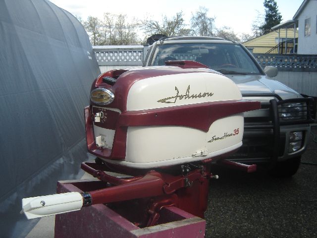

do i need to buy a pressure fuel tank to ran my engine{58 Johnson sea horse 35hp]or just a regular fuel tank?thanks
Re: fuel tank ? 16 years 6 months ago #5073
Commander,
It looks like it may have already been converted to a fuel pump system as the fuel connector has only two pins (lock & fuel). If that's the case, any single line vented tanke will work. A pressure system would have a 3-pin connector (lock, air, fuel). Follow that hose to it's termination. If it ends at a fuel pump (metal and plastic rectangular thing) mounted on an intake cover, then it's been converted.
