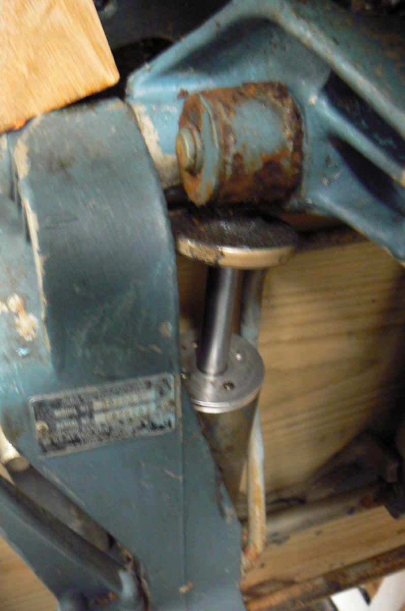

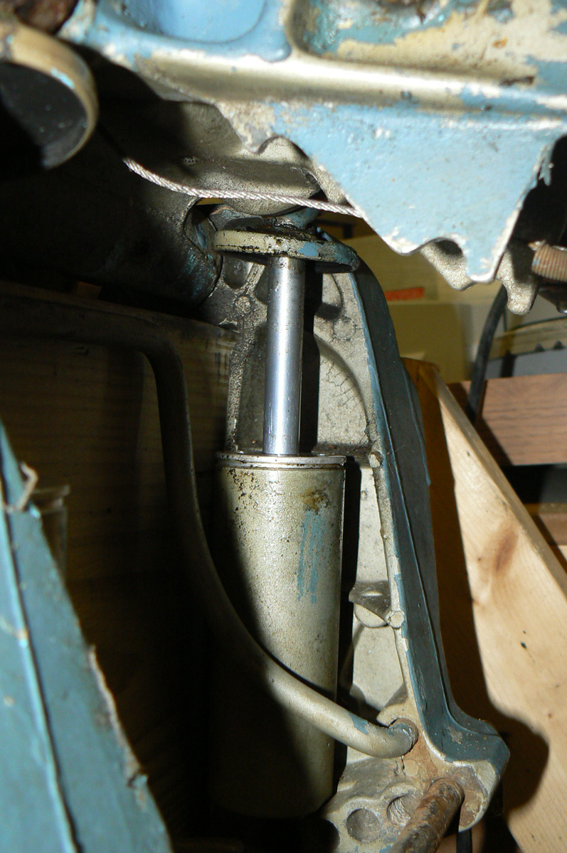

Ok, I got the '67 80hp motor on the stand last weekend but it was a pain since it's stuck in the up position. It's on the stand and bolted down, but it will not come down. It won't tilt all the way up either. I've tried putting pressure both ways, up and down and no joy. Slide the dust boots up can't see any visible rust. Tried to turn the caps with the pin wrench I have and can't get them to budge either, right or left. Tried putting a little Marvel Mystery Oil around the shafts to see if maybe it would seep in and free them up but no joy.
Here are a coupld of pics of the cylinders.
Sorry the first one is a little fuzzy.
Any ideas anyone?

Could take a small punch and hammer.Put the punch in one of the four holes. Tap the caps counter clockwise. Bob, did you check the main hinge bolt for rust or too tight? just a thought. jim

Thanks, yeah nut isn't too tight and I sprayed WD40 at the pivot points of the hinge bolt. Actually used a small pipe over the end of the pin/spanner wrench for more leverage and it still didn't budge.
Re:Tilt stuck, help please 14 years 11 months ago #50681
That's the first time I've ever seen one stuck. Strange. The shocks are/were filled with oil, seems real unlikely that they are rusted inside - but you never know. My thought is that the tilt bolt is rusted or corroded where it goes through the swivel mount. The bold did not have any provision for lube, it had a couple nylon bushings & that was it. Remove the nut on the tilt bolt, and see if the bolt is stuck. Get a drift punch and ball peen hammer and hit the bolt from the threaded end. Be sure the punch is smaller diameter of the bolt so you don't bugger the bolt up. Just do it enough to see if the carriage head on the other side of the engine starts to move out of the hole. Like maybe 3/8" or so. It should drive out easily. If the shocks are stuck, you'll probably have to cut the struts with a cutoff wheel.

BOB,: Bummer , I do not have power tilt, BUT when I went to move my 67 OMC 60 hp Estate find. .Had a very hard time raising UP the lower motor.. There are a few hidden levers / brace stops that blend in with the same green color clamps.
1) in front under power head there is a SMALL thin FLIP lever , left
to right that is a Tilt LOCK / flip pos.?? cable.
2) also ther are some flip down TABS tokeep the motor in the UP or towing position by swivel to the top of C-Clamp, for weight .. Sort of like the early Transom Saver idea.
Again take a close look UNDER neath for something else binding, small screw driver , piece of wood , loose BOLt ., etc , etc,

Thanks I'll try that. I think maybe that has to be it. It seems weird that the pistons would be stuck since they look god and clean.
SPLIT,
Thanks, I did look all underneath. Saw the lock and pull cable. I was able to look at the 75hp lying on it's side to compare. The darn thing is actually stuck 3/4 of the way up. The flip tabs are actually loose and won't come all the way up since the lower unit isn't completely up for it to rest on it.
Thanks guys, will try that later tonight or tomorrow morning.
