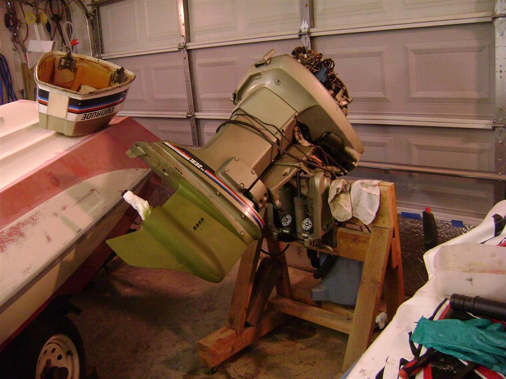

Might as well get this thread started, so here we go;
The wiring harness is disconnected, and from the looks of the relay box for the PT&T, at very least a good clean up of all the connections is in order. The T&T switch in the control handle appears to have seen it's better days as well. I need to lower the tilt and trim to full down to drain the gearcase. The manual (Clymer) I have indicates the release screw is on the Starboard side mounting bracket. When I open this screw, the motor tilts down to rest on the trim rams, but will not come the rest of the way down. Is there another release screw somewhere the manual forgot to mention for the trim rams?
I briefly jumped the green (+) and black (-) wires from the trim pump to the battery, the trim motor kicks on but nothing moves. It's the internal, three wire system, I believe the blue would be up and the green down, correct? I don't want to burn up the motor or the pump before checking everything out carefully. Guess I'd better study up some more before proceeding, just excited to get the ball rolling on this one.

Went out last night to finish removing the "whale tail", one of the bolts thru the AV plate was being stubborn. Whala, she was in the full down position! (Must have left the manual release screw open.)

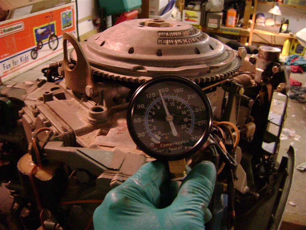

Not really happy with the compression test results, (right around 100 psi on all four), (keeping in mind I have a cheap compression tester). At least they're all even, but it's starting to look like a teardown in the future here. Bypass covers coming off next weekend, stay tuned........I'll try to get some decent pics. :unsure:
Re:1978 Evinrude 115 V4 Model 1115899C 14 years 10 months ago #52690
  • MarkS's Avatar Topic Author
Got a chance this afternoon to re-run the compression test, this time using the factory battery cables instead of cheap jumper cables. Boy, do i feel better! All cylinders within 10%. Guess I should still pull the covers to inspect rings, pistons, etc.? Definitely want this to be a long time runner, so I think I know the answer already.......
Re:1978 Evinrude 115 V4 Model 1115899C 14 years 10 months ago #52710
That's good news Mark. Yeah I'm sure Professor will say yes for sure. ;) I've got 95 on a four for the 80hp and I'm probably going to pull mine to make sure it's good. The 75hp was too rough so I have parts now :) That 115 is very clean and should last you a while provided she isn't scored up.
Re:1978 Evinrude 115 V4 Model 1115899C 14 years 10 months ago #52728

I was seriously thinking I'd bought a "basket case" Bob, I'm sooooo glad this issue is resolved! Another case of my haste (in doing the first test) bites be in the ......you know. :blush:
I did have the muffs hooked up Mike, you just can't see it in the video I guess. She wasn't putting out the tell-tale, but a piece of wire dislodged the mud-dobbers nest and all is well. She'll get a fresh impeller at the very least anyway, and new cup (housing) and plate if needed. I have to pull the lower to inspect, pressure test, etc. soon. Didn't want to waste the time and money if the powerhead was shot.

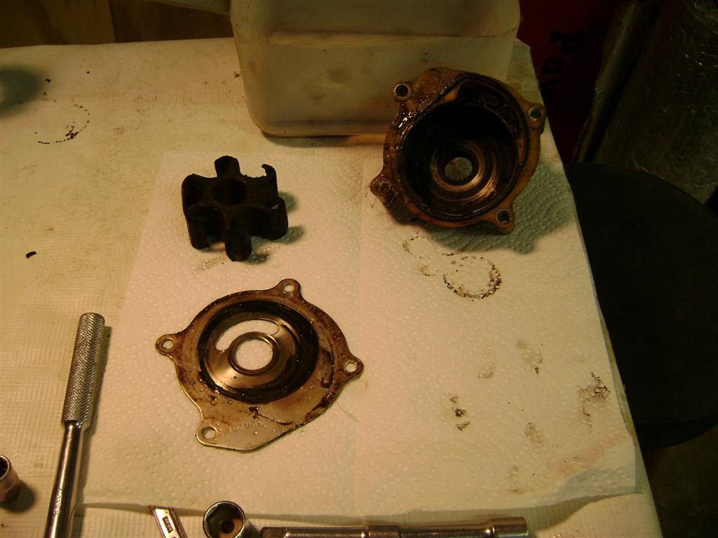

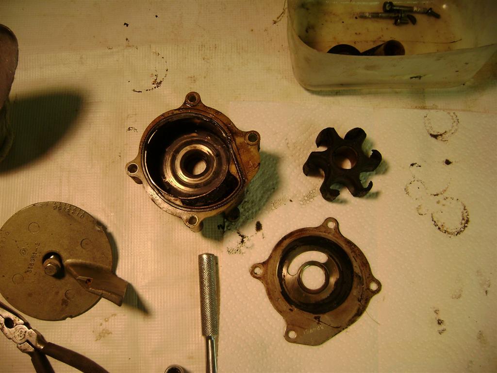

Gear lube was clear of any water or metal, but the water pump is appears to have been run dry by one of the previous owners. a good bit of material from the impeller melted into the housing, the liner is worn through in one place, and plate is trashed as well. I'll order the complete water pump kit next week, but am wondering how much tear down is required to make sure there's nothing plugging the passages in the power head. (She was squirting out the tell-tale well, but I don't think I've ever seen one this bad before.)
Re:1978 Evinrude 115 V4 Model 1115899C 14 years 10 months ago #53191
People still run motors dry
Simply because they do not know the damage it does to pumps.
Re:1978 Evinrude 115 V4 Model 1115899C 14 years 10 months ago #53192
You're right Professor, that's the only thing I can think of that would have literally melted the impeller like that. If you click on the pic for a close up, not only did the molten rubber stick to the plate and the cup, it nearly filled the outlet chamber of the housing to the tube almost plugging it off! I don't find any in the tube (pipe) up to or in the linlet on the power head, so I'm hoping it all stayed down in the pump. The blades of the impeller don't appear to have lost any "chunks", so I think she's going to be okay.

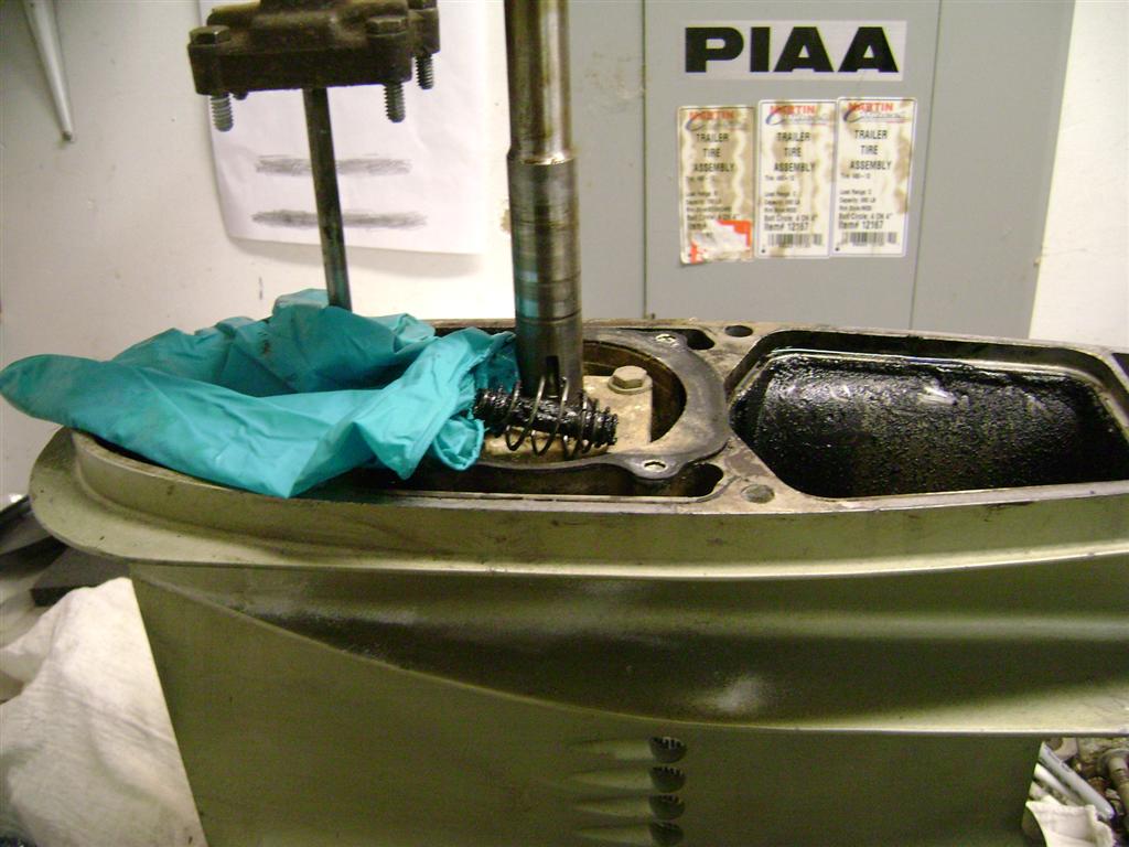

I pulled the shift rod plate up for inspection, and found this piece (looks like a spring, with a rod through the middle) just laying in the housing under the cover. I don't see it in the parts breakdown illustration, any ideas? Edit:#5 maybe, "magnet and spring"? I did notice a very small amount of metal shavings on the spring, it appears to be magnetized.
Re:1978 Evinrude 115 V4 Model 1115899C 14 years 10 months ago #53197
Simple , that is a magnetic " filter " you will find that part in the 66 t0 68 100 HP outboards and also the electric shift sterndrives.

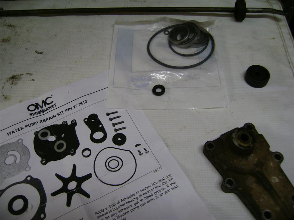

Got a box with all the parts needed (I hope!) in the mail from Joe at Ferguson Poole Marine the other day, looking forward to getting started with re-assembly. Anybody have any suggestions on suitable replacements for OMC gasket sealers etc. referenced in the manual?
Also, anyone happen to know the size and thread pitch on the bolts you would screw into the prop shaft bearing housing to use the puller? None of the bolts I have seem to fit, probably need to use a thread chaser before attempting to do it. With all the gear "dope" laying in the bottom of the housing, I believe it would be prudent to install the seal kit now.
Sorry about all the questions, but it seems foolish to screw something up because I didn't ask a question or two, seriously 'preciate all the help you guys offer!

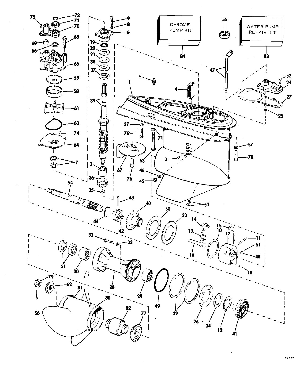

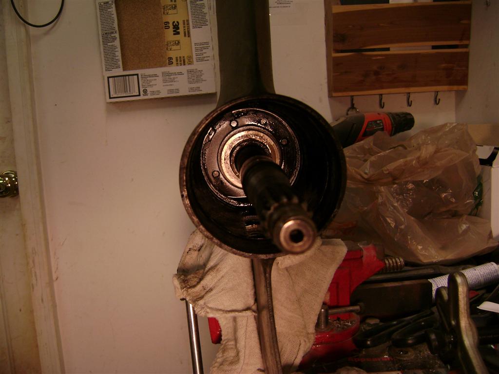

Okay, got the lower unit apart enough to replace all the seals and o-rings, but have a question. The o-ring in the shifter shaft housing, appears to have a brass piece "peened" in the housing on top. No way to replace it from underneath as shown in the parts breakdown, do you have to remove the brass piece to replace the o-ring? Looks pretty tricky to me, may take it, the prop shaft bearing housing and upper driveshaft bearing housing to work Monday and let the machine shop guys give me a hand with that and replacing the seals......? The rubber deflector seal for the shift shaft (above the housing) came in the water pump kit?
Re:1978 Evinrude 115 V4 Model 1115899C 14 years 9 months ago #54442
  • Jim L
  • Jim L's Avatar
  • Posts: 1426
  • Karma: 60
I've never worked on an engine like yours, but I have had that same situation.If you can remove the shifter shaft,can you take a paper clip and remove the old O -ring then work the new ring in place through the hole? jim
Re:1978 Evinrude 115 V4 Model 1115899C 14 years 9 months ago #54445
I hadn't thought of that Jim, I'll give it a try. The guys at work in the shop have a scribe with a hook that may do the trick as well. That o-ring is a real fatty, it's in the first pic laying on the seal kit package. It may be tough stuffing it down the hole, but I'm gonna give it a try! Thanks for the suggestion.

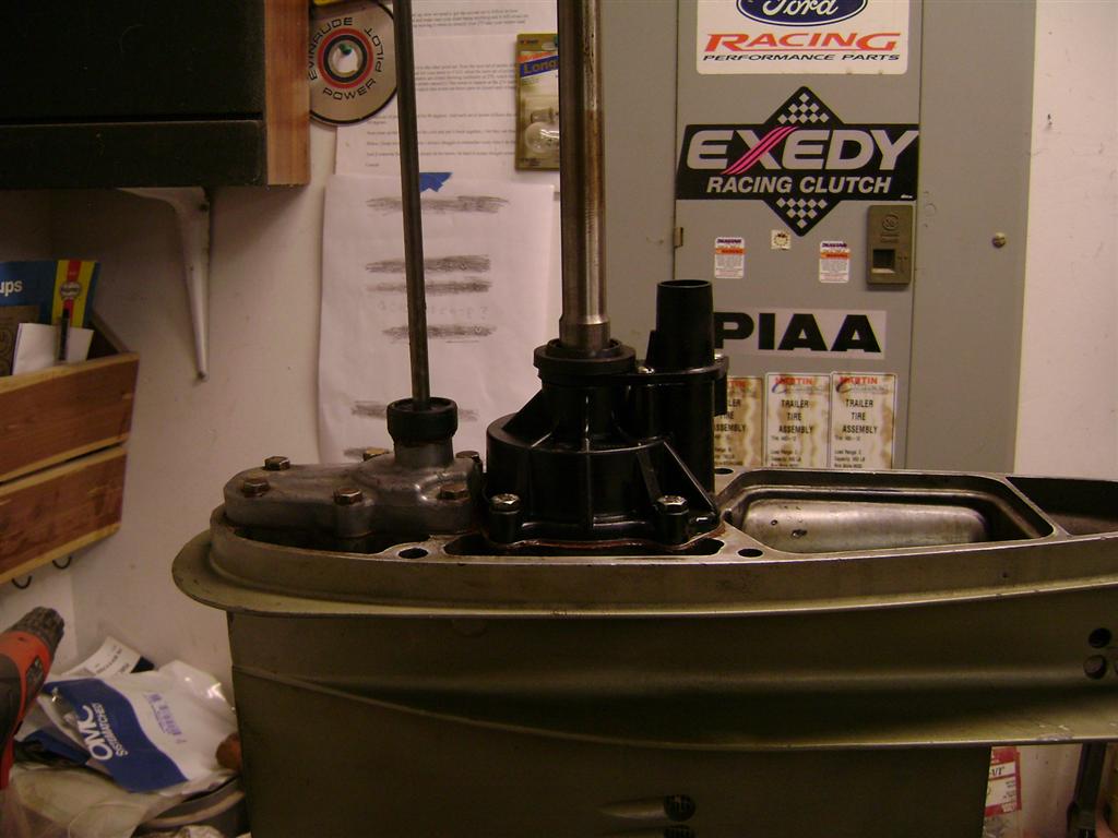

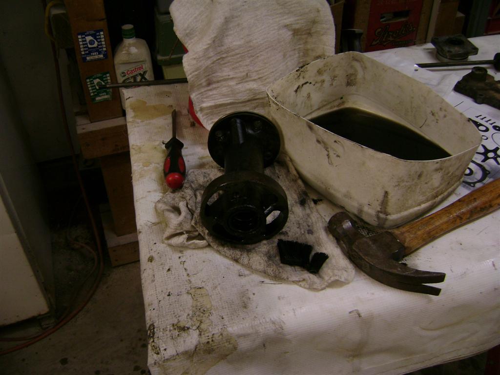

Re:1978 Evinrude 115 V4 Model 1115899C 14 years 9 months ago #54692
As it turns out a paper clip wasn't quite "stout" enough, but a piece of wire coat hanger fabricated into a hooking tool was! :P
Got all the new seals in, water pump kit, re-assembled and installed. I straightened the bent skeg almost perfectly, I'm not going to push my luck and go and farther with it. Still have to rebuild the carbs and fuel pumps, and check out the PT&T system, but we're getting there.
