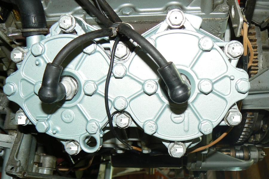

Now you should be ready to go to install the heads. Remove the spark plugs and the bolts on your existing heads. Make sure the cylinders are clean from the old gasket. Shouldn't really be any material sticking to it but if there is remove it. Be careful if you use a putty knife, make sure you don't gouge the aluminum!
Now take the new head gaskets and do the following:
"get a can of aluminum spray paint - not just silver, but the real aluminum stuff. Cut a wire coat hanger into an "S" shape and hook one gasket on the wire while holding the other end. Spray both sides of the head gasket 2 times. While the paint is still wet to tacky, remove the gasket from the wire and lay it flat on the milled face of the cylinder head. (the head should be laying on a flat surface-with the combustion chamber facing up) Now pick up the head & slip a couple head bolts from the bottom side of the head into position. The bolts will keep the gasket from falling off when the head is installed. Pick up the head, bolts, & gasket and position the head on the engine. Slip the remaining head bolts into position and thread them all in by hand, NOT tight yet. When all are bottomed by hand, get your socket & ratchet out. Start by snugging up the center two studs first, then work your way outward to the remaining studs in a spiral pattern (like a coiled rope) Just make them snug, NOT tight."
"NOW you can begin the actual torquing of the head.
Keep in mind that most torque values for outboard engines are given in INCH pounds not FOOT pounds. Confirm which the torque values are given before starting. Take the torque value & divide the number by 3. You will torque the entire head three times, starting with low pressure, and working your way to the full value. For example- if the stud requires 75 inch pounds, divide by 3. (75 / 3 = 25) So, this means 3 passes at 25 pound increments. 1st pass, 25in. lbs, 2nd pass 50in. lbs, 3rd pass 75in. lbs This process helps keep the head or block from getting distorted." The pic below has the number sequence but they're small sorry.
Make sure you follow the OMC pattern and the maximum torque values. The pattern as stated earlier is to snug down the center two studs then spiral outward. The whole process shouldn't take more then 10 minutes or so once the gaskets are painted and ready to install.
Put the spark plugs back in and be careful not to overtorque them also. Now turn the engine over by hand and make sure nothing is hitting or catching. Lesson learned: didn't do that and there was a problem to be explained later.
"After the engine has been run up to temp shut it off & let it fully cool. Re torque the heads using the top number (3 steps not needed this time) to be sure the heads are properly torqued after run-in. Do not be alarmed if tiny blisters or pills of silver paint appear at the gasket edge - this is typical.
The silver paint actually melts & makes a fantastic sealer without a gooey mess."
You should now be ready to go and take her out for a spin. You should notice a significant improvement in horsepower and speed. Should be close to what a 75hp will run. It will also be more efficient on the fuel burned but she will still be a gas guzzler but faster and burn more of the fuel in the cylinders than it did before.

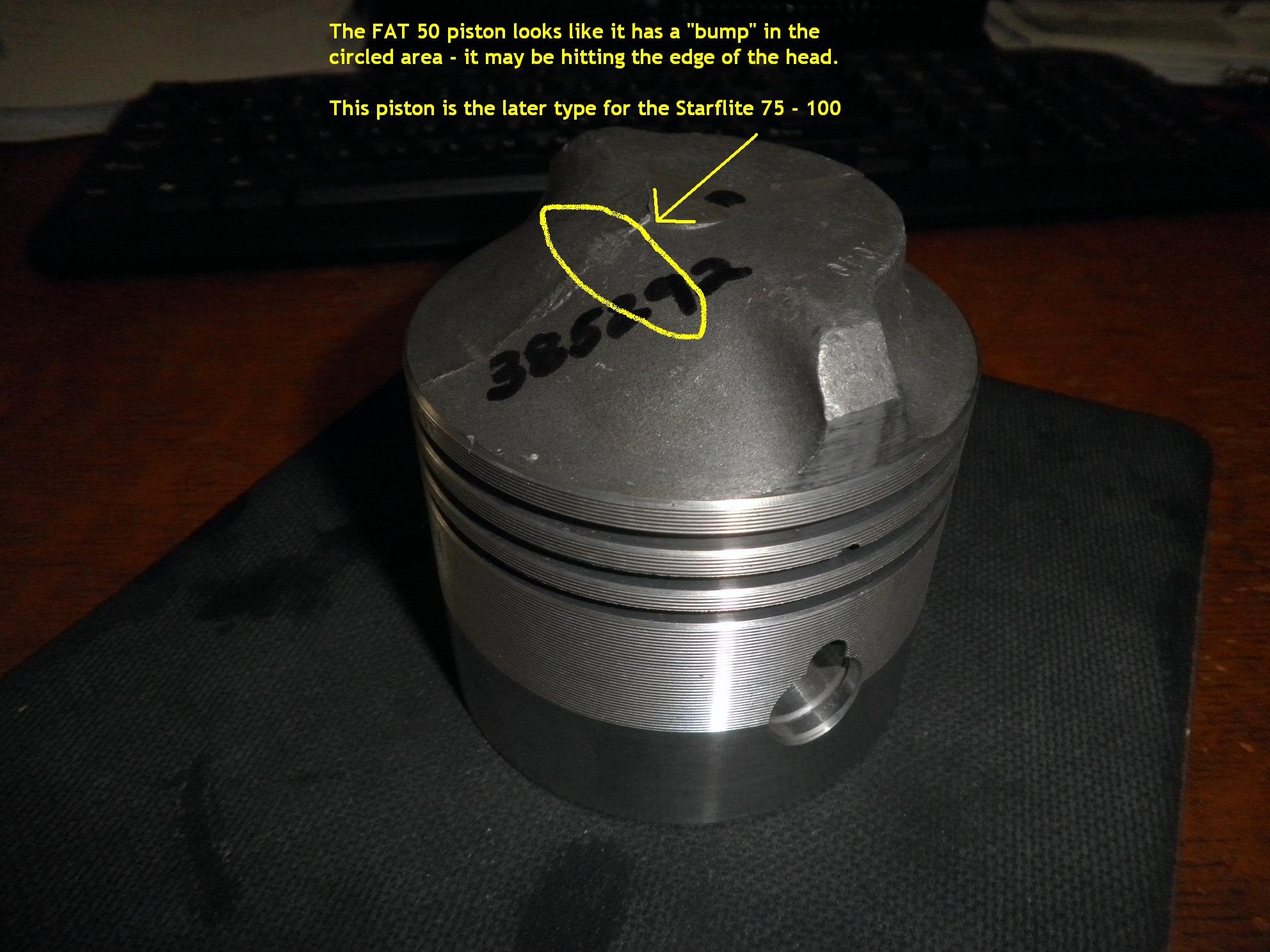

Now for the other lesson learned as mentioned earlier. Make sure you turn the engine over by hand to make sure nothing is hitting. I didn't and didn't know there was a problem until I started the engine and heard a bbrrrdddd sound like something was hitting. Checked to make sure the spark plugs weren't too long, nope that wasn't it. Took the heads off and yep sure enough pistons were hitting the heads.
This is where I said you need to make sure you use a reputable machine shop. It appears the one I used took too much off and there was no clearance left. Guess I should have listened to the OMC dealer who said he sends all their heads to a chop in Arkansas!
Moral of the story is to do your research on machine shops and always double check to make sure they've done what you asked. By the way I have since put the old heads back on and the engine is fine, pretty bullet proof actually. I will try this again but for now I have found another way to get some more horsepower.

Re:Hot Rodding a Fat Fifty, a lesson 14 years 7 months ago #52904
Your not hitting that hard. Machine the piston in that area back a tenth of an inch or so and run it.
A file or dremel will do.
Conrad
Re:Hot Rodding a Fat Fifty, a lesson 14 years 7 months ago #52989
  • Waterwings
  • Waterwings's Avatar Topic Author
  • Posts: 4902
  • Karma: 107
  • Thank you received: 100
Conrad,
Thanks, hadn't thought of that. Is there enough meat at the top of those pistons, well side of the crown, to do that without screwing them up?
I guess another question would be do the '62 75hp heads fit the Fat Fifty? Maybe I have a reputable machine shop give another go at the 75 heads since the block is too scored.

That deflector atop the piston is solid aluminum, so I'd expect a little filing won't hurt a bit. Don't think 75hp heads would fit right, since the bore on a 75hp V4 is larger.
You could use some modeling clay or Silly Putty to check clearances between piston & head, once the clay squashes you'll have a real good idea of how tight clearances are............ed
Re:Hot Rodding a Fat Fifty, a lesson 14 years 7 months ago #53094
  • Waterwings
  • Posts: 4902
  • Karma: 107
Cool, thanks Ed, great idea. I'll just have to make sure I file the same amount on both sides so I don't get the pistons out of balance, I would assume.
Re:Hot Rodding a Fat Fifty, a lesson 14 years 7 months ago #53101
Yes there is tons of meat up there to move back. You can file appoximatly the same on each side to help balance. But honestly what your going to take off is not much to worry about. Ive never worked on a V-4. Only L6's Yep mercs. If the con rod lets you take that piston out easy on the V-4 just slide it out and put that piston up to a grinder . Before doing it score some marks a 1/10th of an inch lower on the piston deflector so you know how much youve taken off and where to stop. Do both sides and if the other pistions need it do them quick too. No sense having it knock at high RPM. If the pistons are hard to pull out. Then just hit it with a hand grinder or dremel. Put some axle grease on top of the piston just under where your working to catch the junk then wash off with solovent when done. I bet in about a half hour youll have it done and ready bolt up and go off to the races.
Conrad
Re:Hot Rodding a Fat Fifty, a lesson 14 years 7 months ago #53102
I just looked again. Those piston deflectors are easy to get at. A fairly aggressive hand file will get the job done in short order. If you have a shop vac have it running right where your filing and suck up the filings as you work.
Should be an easy fix.
Good work
Conrad

Frank, yeah they should be fine just like they are. Mine barely hit after the milling so you should be just fine. What I would do just to make sure is keep the old gaskets on, put on the 60 heads, torque them down and turn the motor over by hand to make sure the pistons don't hit the heads any where. Once your sure they don't, take the heads back off and put the new gaskets on using the technique mentioned earlier in this thread, (the paint method), torque down the heads down, run the motor to warm it up, let it cool completely, then re-torque to make sure and you should be good to go.
Bruce, no worries, motors still good. No blood no foul. ;) What are your feelings on what Conrad suggested about filing the pistons down some to clear? I'm working on that '67 80hp as a back up motor in case something happens to the fatty. Needed a backup anyway.
Re:Hot Rodding a Fat Fifty, a lesson 14 years 5 months ago #56229
Best bet on checking piston clearance is to put the head from the "60" on the "50" WITHOUT the head gasket & then rotate the engine by hand to check for any clearance issues. Just put the heads on with a couple of bolts per head - just to hold them in place fot checking. Snug the bolts just enough to hold the heads in position. Note - Be sure the heads are on the correct side of engine . :unsure:
If the pistons clear with no gasket - they will surelt be fine when the gasket is installed.
Bob - I can't see a problem with trimming .075" or so off those deflector brows. Just be sure to not gouge the gasket surfaces.

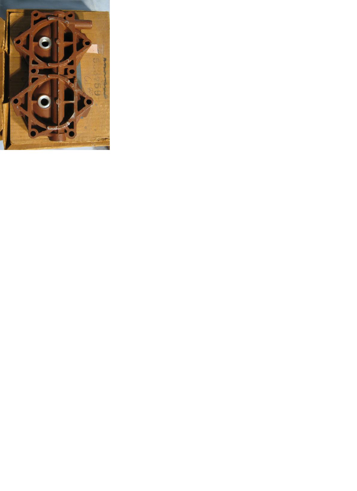

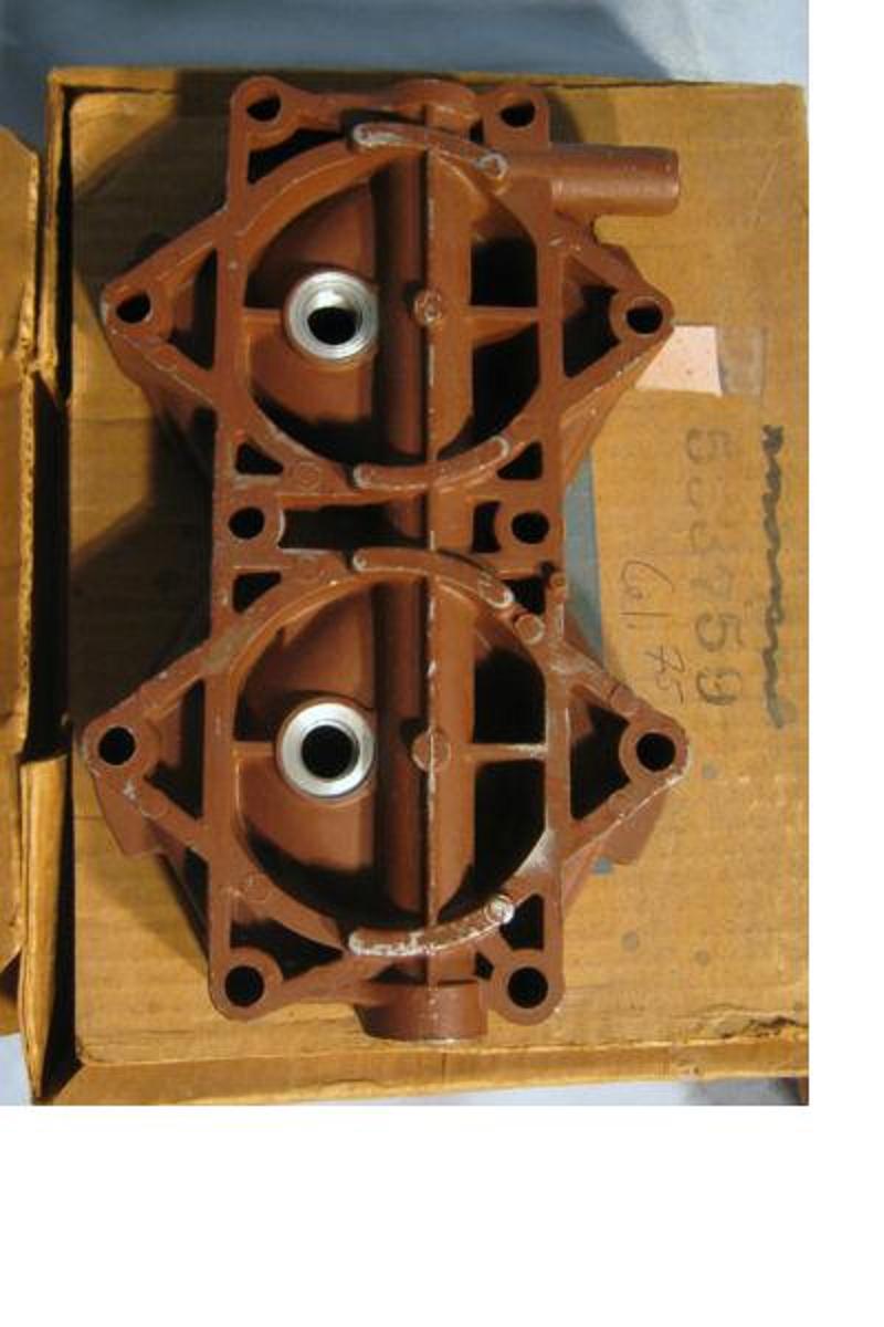

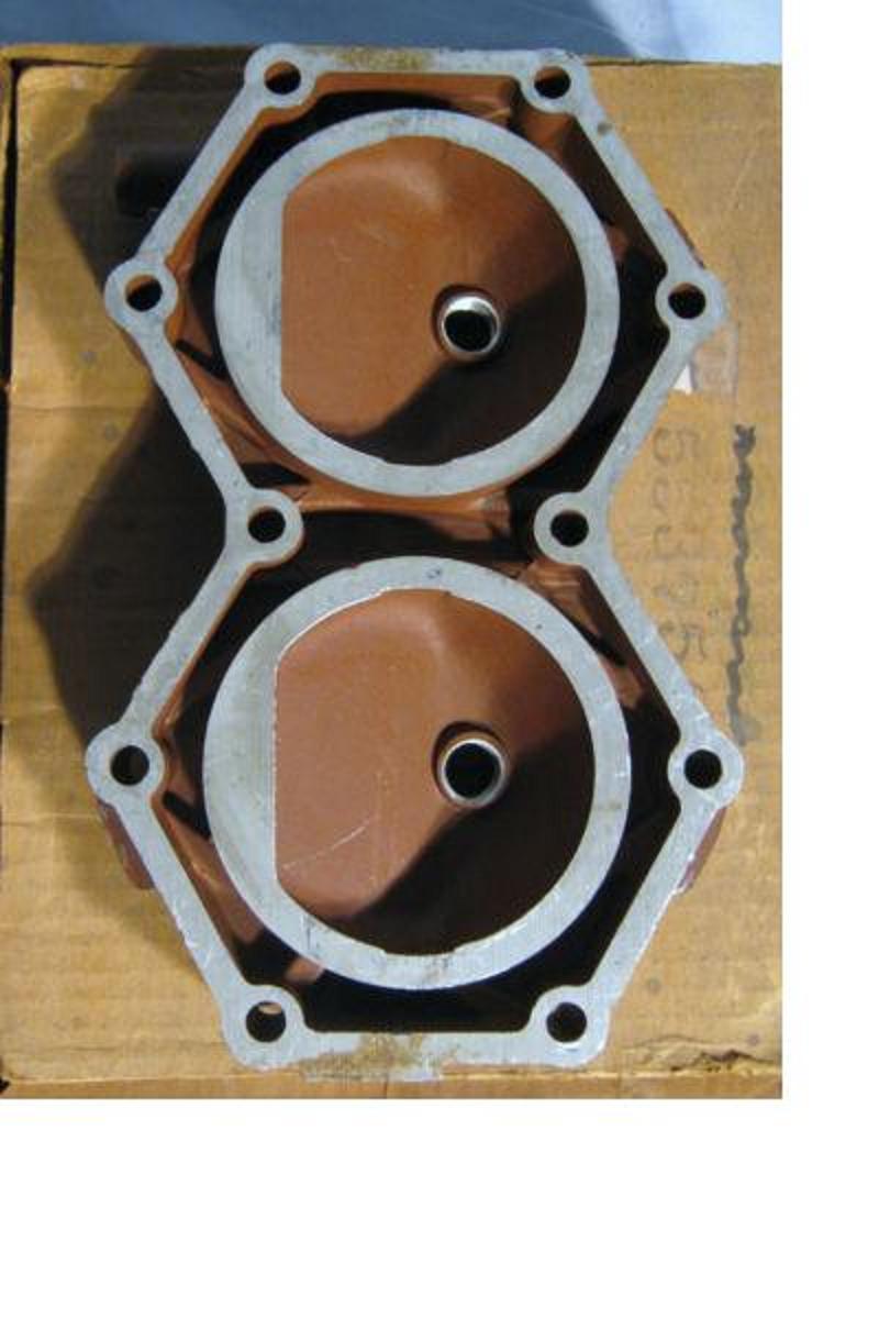

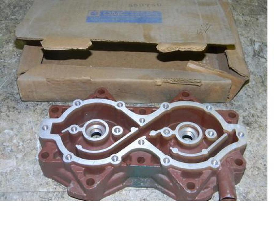

Re:Hot Rodding a Fat Fifty, a lesson 14 years 5 months ago #56266
Get the cylinder head part number from Bob, or from another reliable source. To the untrained eye - dozens of cylinder heads look to be the same part. But that is not the case. The Fat 50 and the later OMC 60 and 65 V4 engines has a smaller bore than the 75 hp and up V4 motors. The 75 hp and up were 89.9 cubic inch - much larger pistons than the 50 - 65 hp motors. But a part number is the best way to identify what you are looking for.
Below are 5 pictures. Study these to see the differences in the heads, and why the changes were made.
Look at the shap of the piston tops in picture #1. That "eyebrow" part is called the deflector. It helps direct the fresh intake charge upward ti the top of the cylinder. If it was not there - the fuel charge would just head straight out the exhaust ports on the opposite side of the cylinder. This is only on Cross Flow engines - Loop Charged engines work differently.
Now look at the 2nd and 3rd pic. This is a NOS Fat 50 head. Look how the chambers are open - like a soup bowl. The piston yop is not shaped like this, so there is a lot of empty space around the head and the piston. This INCREASES the volume of space between the head and the piston - resulting in decreased cylinder pressure. Also note the only cooling it has is a pipe that runs from one end of the head to the other. This creates hot & cool spots in the combustion chamber.
Photo #4 & #5 Here is a NOS 60 & 65 HP head. The water jacket cover is off this head, and asy you can see when there is water inside the jacket, all of the cumbustion chamber ceiling is cooled - chamber temp more uniform. On the underside - look how the combustion chamber has been modified. The chamber has been contoured to the profile of the piston top - allowing for a tighter squish area - increasing the cylinder pressure.
There is a lot of good marine engine info on the internet - if you find this stuff interesting.

Bruce, more great info thanks. Pic 2 and 3 must be those stealth heads I keep hearing about. LOL
