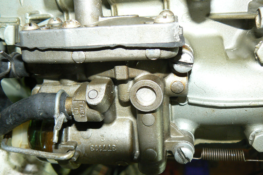

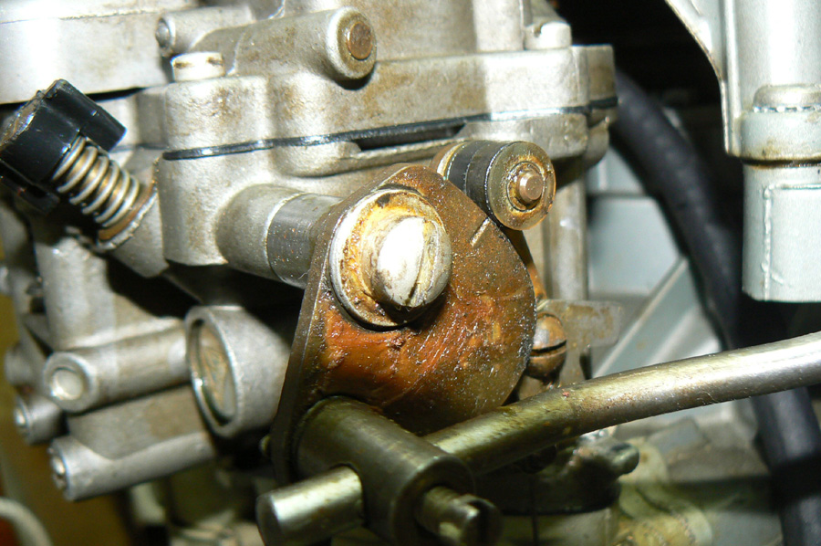

"Remove the large slotted screw, spacers and washers from the throttle cam that is attached to the carburator. Observe the order of the parts. Detach the throttle cam from the carburator by swinging the throttle cam and rod out & away from the carburator. replaceplace the screw and washers on the carb for safekeeping."

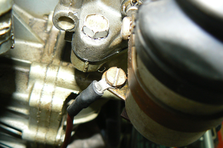

"Remove the wire from the electric choke solenoid & move the wire aside."

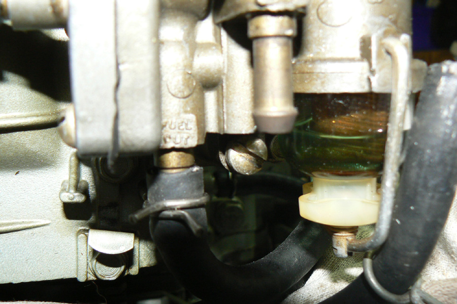

"Remove the fuel pump. If the lines attached to the pump are supple, they may allow the pump to move out of the way enough so they don't need to be removed from the pump. Check all lines for cracking - if in doubt, replace them."
Pics of the fuel lines to remove.

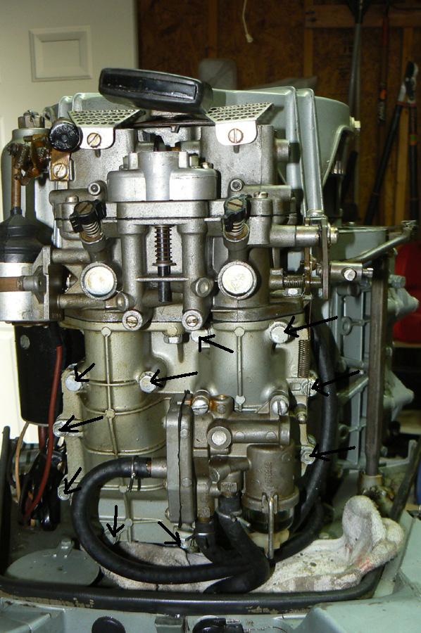

"Loosen all of the intake manifold bolts & back them out slightly. (1/4" or a little less)
If the intake manifold does not start to drop away from the block, place a wood block against the carburator (where it will not damage exposed parts) and give a couple smacks with a hammer. Don't get carried away. The manifold should pop loose, unless you have missed a bolt, or someone has previously used silicone on the gasket. The goal here is to pop the manifold loose without ruining the gasket, otherwise you will have to replace it."

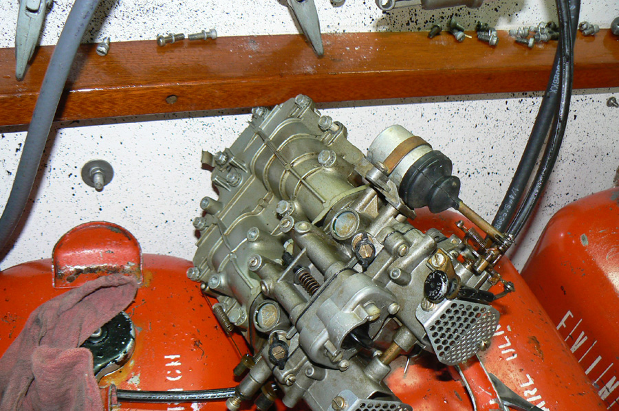

Other lesson learned, take picture of carb/intake assembly with fuel pump off so you can see the two hidden bols behind it.
"Remove the previously loosened manifold bolts & carefully move the manifold and carburator assembly to the side."

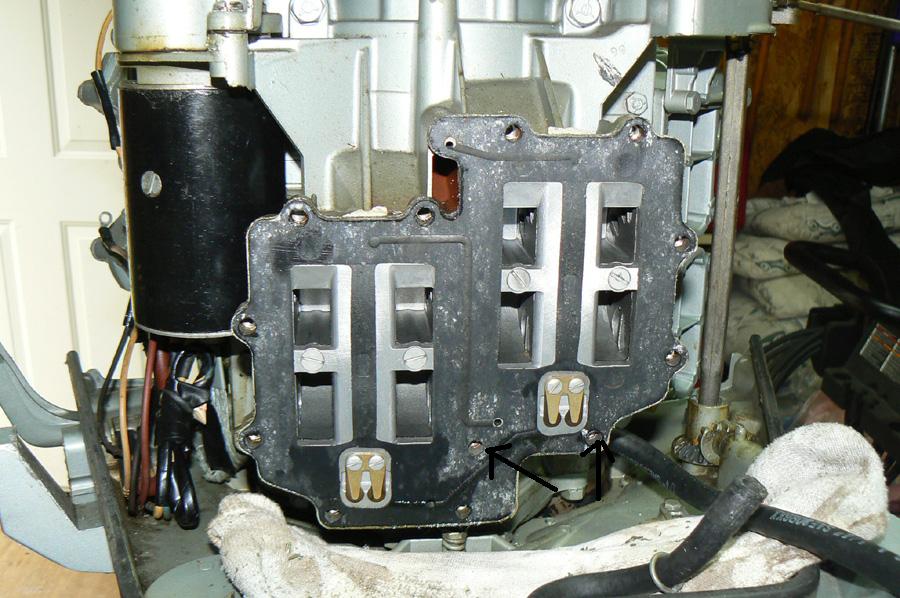

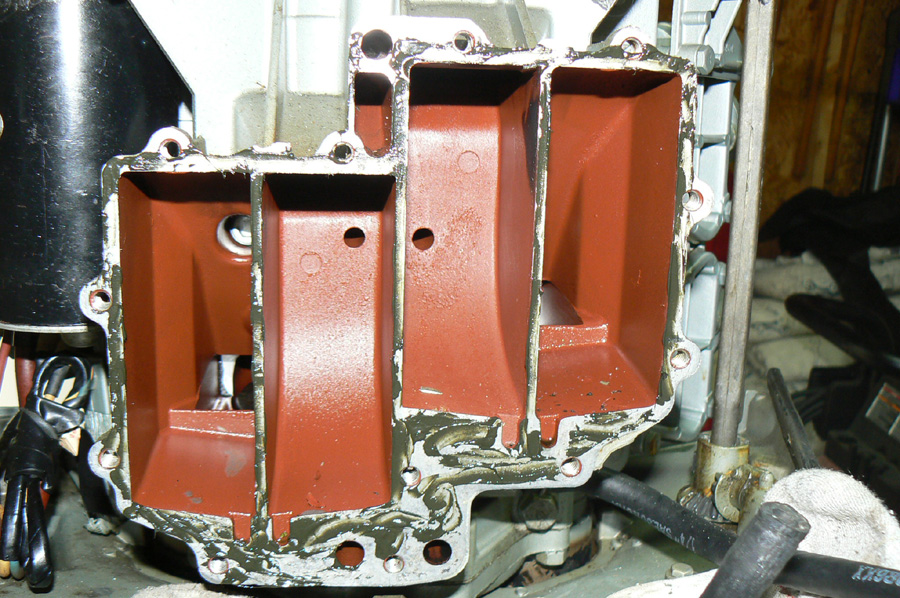

"At this point, you should be looking at the front side of the reed plate assembly, unless it came off with the manifold. Place a sharp edge of a wood block against the outside edge of the reed plate where it meets the engine block. Give it a sharp blow with a hammer to loosen it. Remove the old reed assembly. Check the crank case flange for any old gasket or sealer & clean it."
Pic of the old reed assembly before removal. Notice the two arrows to show the bolt holes from the hidden bolts behind the fuel pump.
"Smear a light film of Permatex on the mating surface of the crank case & place the new reed assembly into the intake cavity. If the original intake manifold gasket looks OK, smear a light film of Permatex on the mating surfaces and re attach the intake manifold and carb assy. DO NOT over tighten the manifold bolts."
I also have a layer of Permatex on the gasket in the reed valve assembly so don't be too concerned with the gaps in Permatex you see on the intake manifold.
