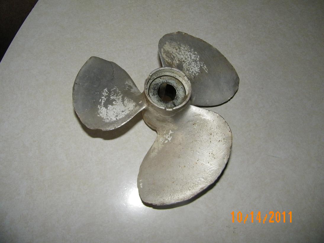

I have an old 25hp Im trying to find a prop for so I can use it on my project boat and I cant find any.
73 Evinrude 25hp NOT thru the hub exhaust.
Any suggestions? I really need something like a 10x12 if available.

I have an older one that might fit, I think it came off a 28 hp. It's stamped 10 x 9 1/4. Has rough edges but is rebuildable.
