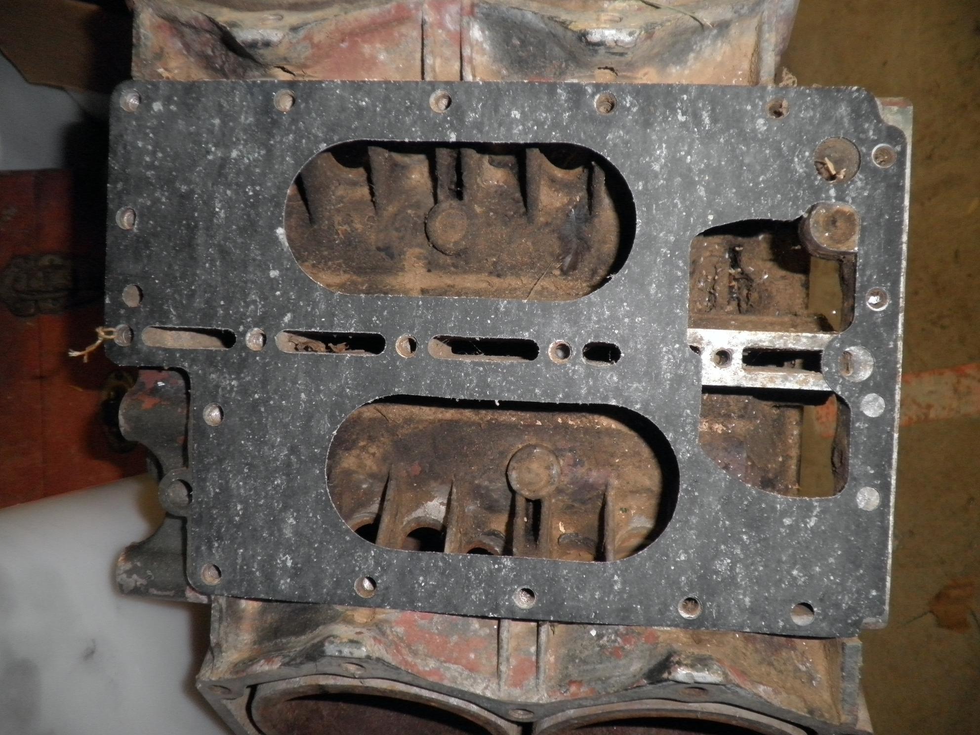

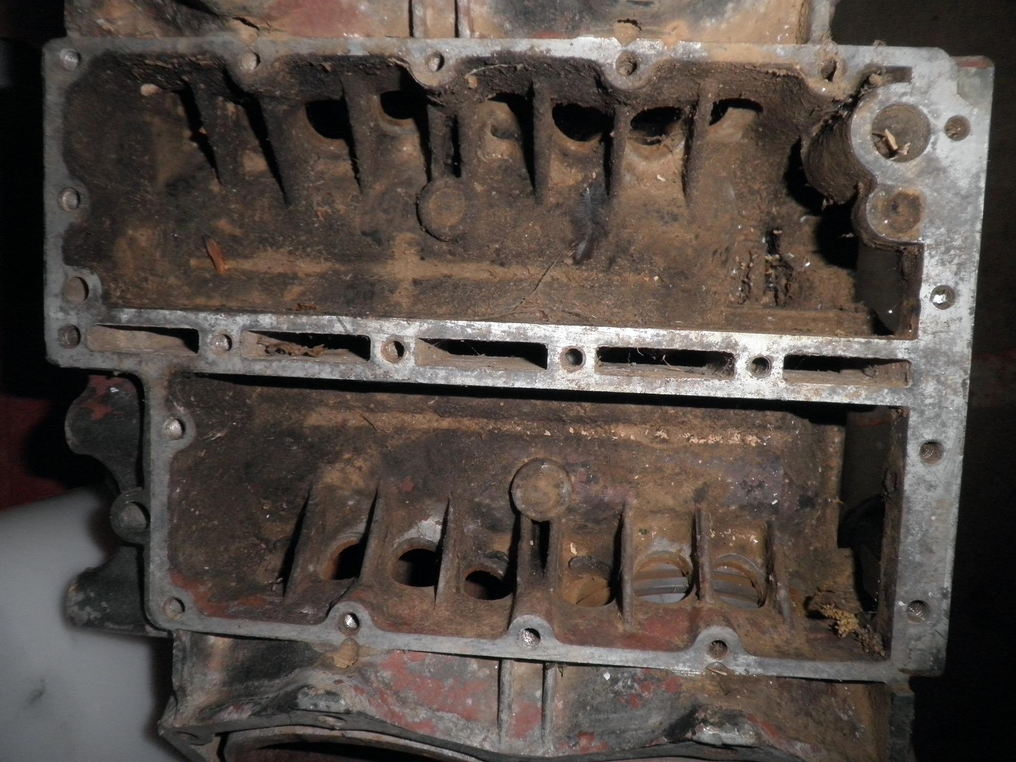

Here is 50 block from my bone pile (1st pic) with a 140 bubble back gasket dropped on (2nd pic) as you can see the outline and the bolts holes do line up as I said they do. The 115 & 125 gasket would have the center water jacket poerion that is deleted at the lower 1/3 of the 140 gasket. I don't just sit around and dream this stuff up.

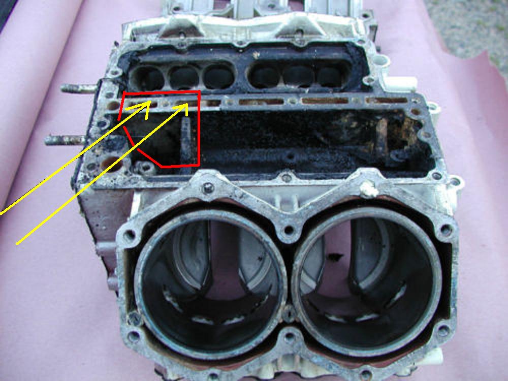

Below pic is a 115 block. There are 5 water passiges in the divider that run to the main water galley between the cylinder banks.
The red lines outline the area omitted on the 135 & 140 blocks. This would have to be milled away from the 115 block. The area contains 2 water passages (yellow arrows pointing at them) the openings for these passages would require welding to close them off

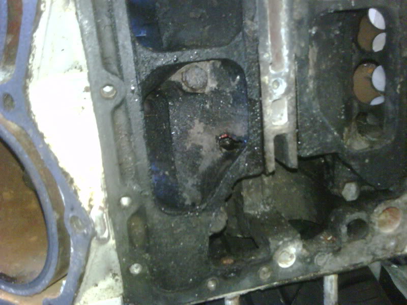

The next picture of the 140 block clearely shows where the casting was modified & the bottom 2 divider passages plugged. This would have taken just a slight modigication to the mold at the foundry.

On the newer say late 80's ----NON BUBBLE BUTT blocks
I would say those bottom 2 water jackets do not go into the main water jacket down the center of the block.---No welding required to modify them , just some simple machining.
