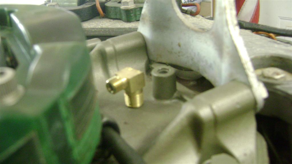

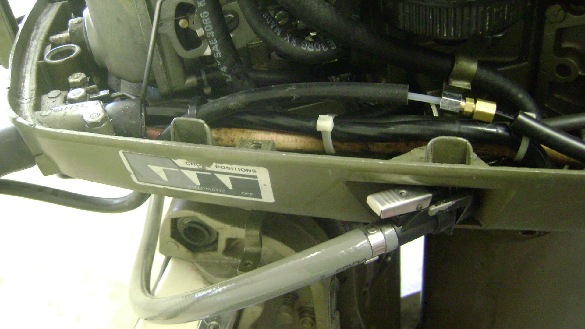

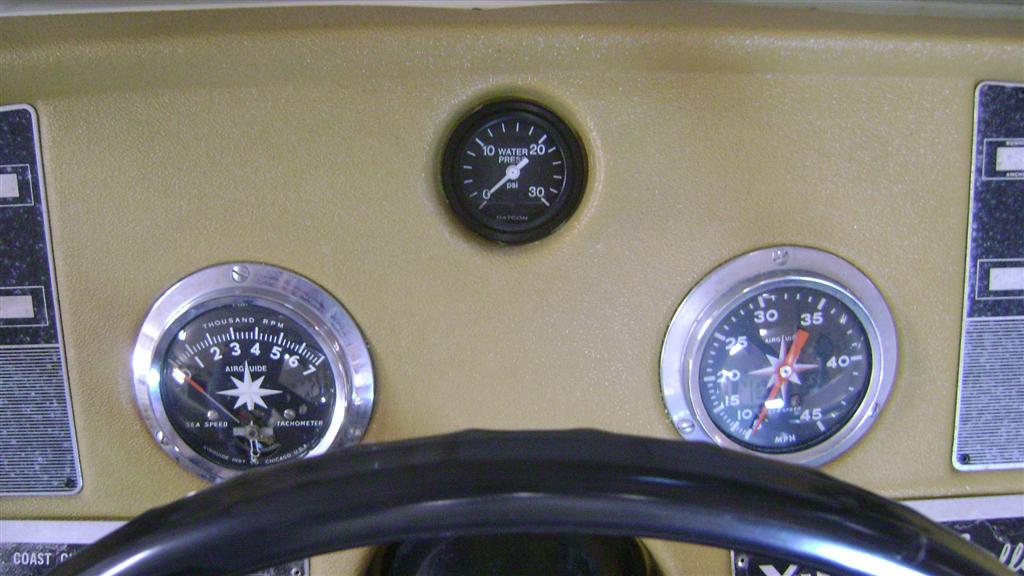

Need some help here, y'all. I'm trying to hook up a water pressure gauge on my Johnny V4, got the gauge installed in the dash and the line run back to the motor. Thought I had the answer to where to tap into the cooling system to get a good reading, now I'm not so sure.
The V4's have a water passage cover between the V on top, looks like a "cast in" place to install the fitting. Problem is the fitting will be too close to the flywheel! (We don't want a broken water line, now do we. :S ) I thought about going just forward of that and drilling and tapping a hole there, but don't think it will be thick enough to hold threads securely.

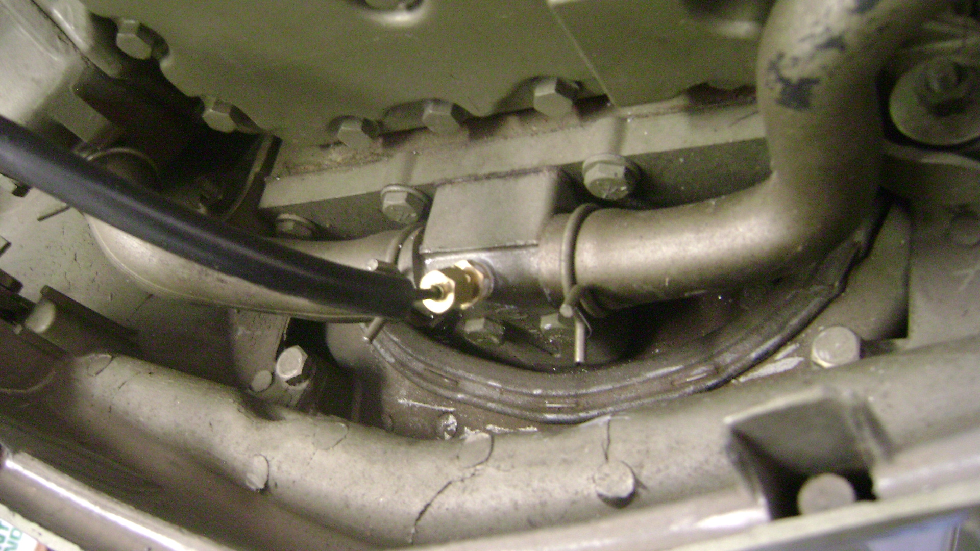

Well, I ordered two new hoses, and just thought better about cutting them up and having to fabricate some kind of adapter fitting to go into one of them. Also, the way they are curved, (which is why I didn't just use bulk hose), it would be tough to do. Soo, I drilled and tapped the housing (thermostat) where they meet and guess what. Getting no reading on the gauge. Now what?
Guess I'll take it to the lake and check it out right!!!
Re:73 Johnson 115 V4 Water Press Gauge Hook-Up ? 16 years 6 months ago #4620
  • MarkS's Avatar Topic Author
Lake test on gauge = GOOD! Must have taken a few more minutes to get the pressure up the line to the gauge.
