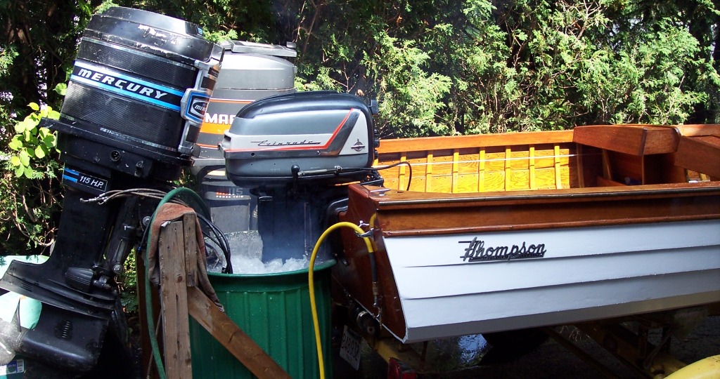

OK carb done...check! she ran smooth
installed new points and condensers had beautiful spark.
Started it in the tank all was going well then in the tank before I headed to the lake lost spark on cyl 2 still had spark on cyl 1 COOL.
Pulled off the peek a boo in the fly wheel and tripled checked the gaps on the points. Cool everything nice at .20. Got spark back on cyl 2!
Tried to start her again. No......now NO SPARK on either.
No kill switch in this motor you use the choke to knock her out. The coils look like replacements and they are not all cracked.
Any ideas? Something has to be causing a ground somewhere yes??
I Think NOT on the grounding issue. When I first pulled the flywheel off this old egg beater the woodruff key was broken. I figured someone tried to put the broken pieces in and let her run like that. She was dirty under the flywheel so I replaced the points and condenser and clean thing up while in there. I got a new one and I replaced the woodruff key this morning. Now after losing spark again I went out and pulled the flywheel again and the new woodruff key was snapped just like the first one I found in there. Spark plug # 1 was sooty and black the other clean. Would H20 in cyl # 2 be the culprit?? Anyone ever run into this? Anything particular about these model Evinrude's that anyone is aware of??

yea when I pick up the new Key on Monday that is my plan of attack. She ran beautiful for about 20 to 25 min in the barrel then she went awry.

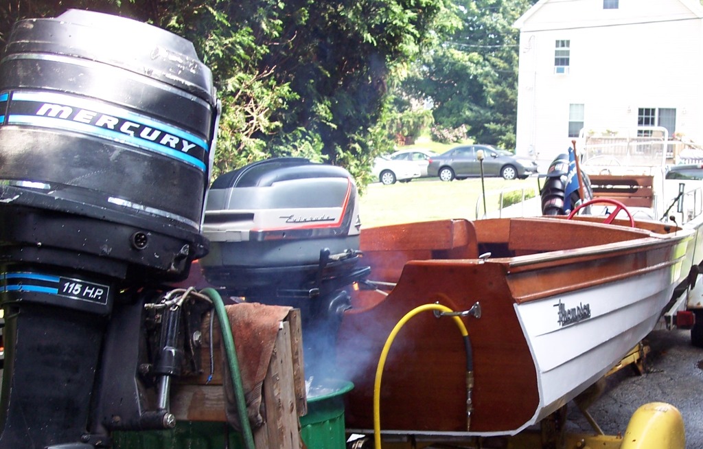

Replaced the woodruff key with a brandy brand new one. Made sure everything was clean and dry in there re checked the new point settings etc....
The torque rating for the flywheel is 65 foot lbs I brought it to 65 lbs ran it for a while then shut her down and brought the torque to 73 lbs where I will leave it. I did that since the nut is not new. So far so good. Hopefully she will hold on the lake for her final adjustments. I had a heck of a time removing the fly wheel the 1st time when I found she had no spark in the 1st place. When I got it off finally I found the original woodruff broken.
Fingers are crossed!!
