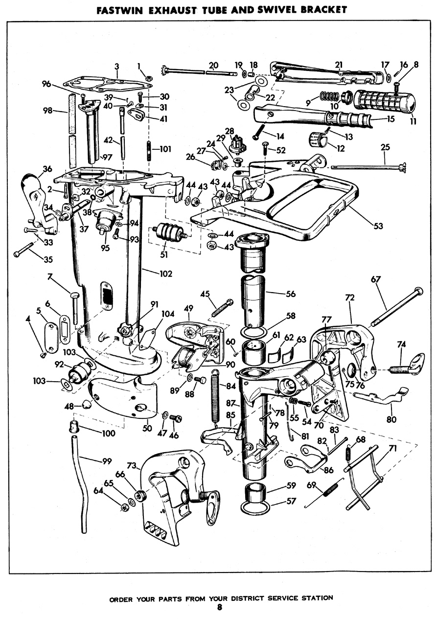

Re:1957 Golden Javelin 35 Problem 15 years 3 months ago #40130
On the ron that the shift handle is bolted to either outside or inside may have come lose. If either one has come lost the shift rod will not mover up or down. In the digram here look at part 34. you may have to zoom in to see it better but check that rod.
Mike aka pathfinderz1
Re:1957 Golden Javelin 35 Problem 15 years 3 months ago #40144
Here is the manual for the 57 Javelin...pages 14 to 17 has the parts for the shifter
