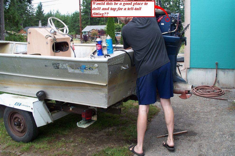

Apparently this 1977 75 hp 3 cyl looper was not equipped with a tell-tail.
Model: 75743S
Serial: J0001073
I would like to add a tell-tail.
Would the place I have circled in the attached picture be a good place to put it? Or where would be best?
Thanks,
Thom

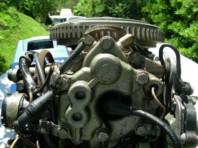

Re:Adding a tell-tail to a 3 cyl looper 15 years 3 months ago #39676
Think that would work, but I think it better to put it as high as possible. So on mine I put it on the top of the head just forward of the thermostat cover. Don't have a picture but could take one later today. I like it up there so I can be sure the water is making it all the way to the top.

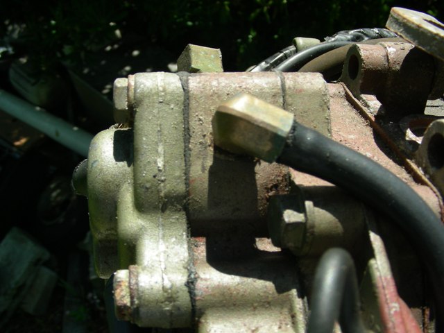

Re:Adding a tell-tail to a 3 cyl looper 15 years 3 months ago #39695
Thom,
Here is picture of mine. On right is pisser, on left is fittiing to water pressure gauge. If I were to do again, i would place a little higher so end of barb clears head bolt better.
