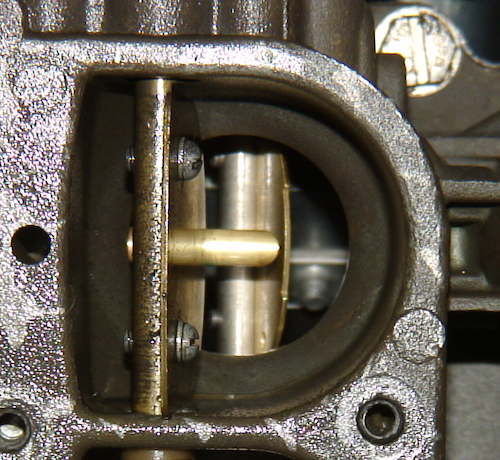

#3: The throttle butterflies do not open completely at WOT. In the picture below if the butterfly was completely open, only the edge would be visible. I cannot adjust it open simply with the throttle cable adjustment and I'm a little reluctant to start fooling with the distributer linkage as that's what got me in trouble before.

Re: Should the Butterflies be open all the way at WOT? 15 years 3 months ago #38588
Chinewalker wrote:
They should. Looks like you need to do a link & synch...
Mmm-Hmm, so what's the step by step on that? I know about hitting the marks on the throttle cam but I had a devil of a time getting the distributer synced.

Should the Butterflies be open all the way at WOT? 4 years 2 months ago #147160
Not sure if this was answered? I just went through this though.. the fuel saver linkage needs to be set up correctly..
The magneto has to hit boss on back of powerhead.. set the fuel saver set screw.. butterfly in carb will be 3/4 open or close to.. the little extra left on throttle control will move throttle linkage to open butterfly 100% open.. fuel saver set screw allows linkage to pull butterfly open..
