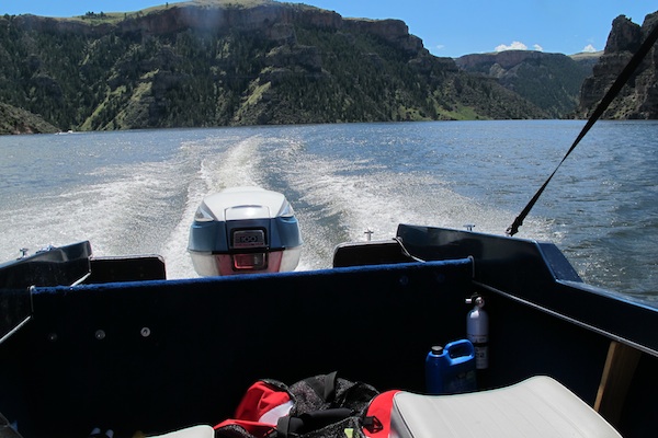

Picture in a minute, it was a beautiful day.
(As promised:)
