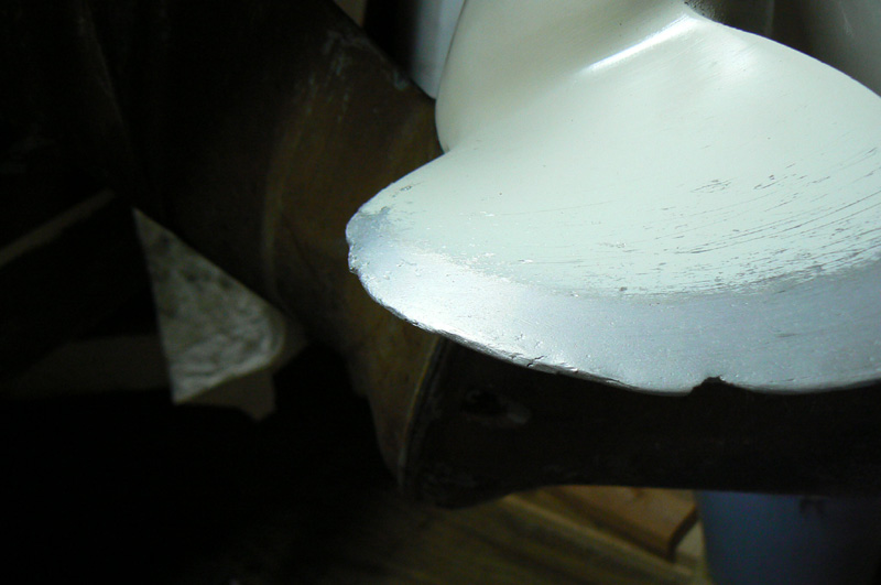

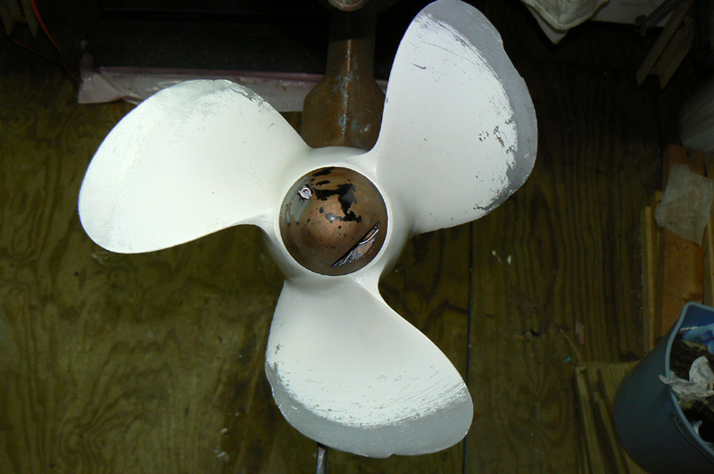

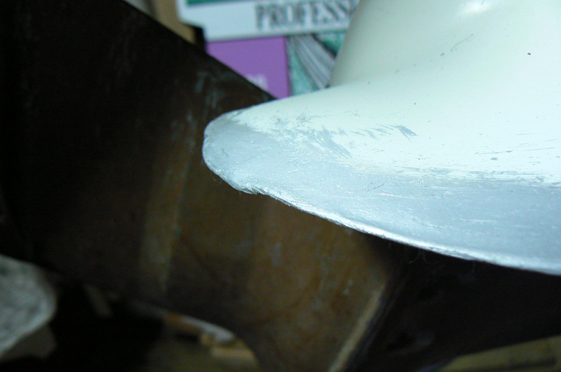

OK, so Bob the idiot (me) was able to find the only chunk of something in the water close to where we always ride. Been by the same section just the week prior and nothing. Saturday, going about 8 mph bumo and up comes the motor, thank god she wasn't locked! :ohmy:
So now to my question, am I ok to use this prop again this weekend before I find another one?
The skeg is fine, the big chunk is new and the little bends are new. Doesn't look like the shaft bent either. The part number form the old maual says 278155. I have another one but it's much worse than this one. Apparently dad found plenty of rocks and logs in Lake St. Claire.
It's a 12 1/8 x 14 prop, at least that's what the box for the other one says.
Noy having a lot of luck finding one local either.
Any suggestions on if ti's ok and where a good place to find another reasonabley priced one?

Balance is what you need
You can take some off the other blades as to balance it..put it on a welled oil shaft and spin it as to see where it stop...if the same blade ends up on top then the other two needs to be filed down
Not cheap but they are good
www.propcopropellers.com/evinrude_Outboard_Prop.htm
or send on to be rebuilt
www.propmd.com/

I don't think I'd take a chance running it that way if it were mine, Bob. It's gotta be out of balance, and could cause bearing and seal damage in the LU, which could get expensive quick! Just my two cents, I'm no expert. Sorry about your bad luck there buddy. :S

Re:Prop help/question? 15 years 4 months ago #35648
If this is the 100 HP motor V-4 then you could try a 16" pitch.
Used to ski behind a 17' Deep V boat with 4 people and 2 on single skis.
No problem at all.
You can run that prop for a while ( week end ) if you have to.----Damage can be done if you run it long term.

Re:Prop help/question? 15 years 4 months ago #35663
Ever look at the bearings in a fat 50 lower unit??
That little bit of damage will not harm them.-As far as I know there was only one prop offered for that 50.

Professor,
I know the other bad one is a Michigan Wheel PJ-50 which is 12 1/8 x 14 but when I did some searching it says that it's fro 14' - 16' boats. I also founf on Ebay a Pj-61 that's 12 x 13 and is suppose to be for 17' - 19' boats. My Clipper is an 18' so I'm curious if I can get away with that one since it looks new and what will it do to the motor. I can't remember if going down in pitch raises or lowers the motor RPM.
Re:Prop help/question? 15 years 4 months ago #35673
Bob,
Going down in pitch is akin to shifting down in your car - RPM goes up! You gain pulling power at the expense of speed. Also, worry less about the "boat size" recommended and go by actual RPM when choosing a prop. Things like load, hull design, set-up, etc. all come into play and can throw their recommendation out of whack. Ideally, you want a prop that peaks out a little above the high end of your motor's recommended operating RPM range (with a light load), which leaves you some wiggle room when you take on passengers and gear. Can't recall off the top of my head, but I think the RPM range on your motor is 4000-5000 RPM with the hp being rated at 4500. Aim for a high reading of 5000-5100 RPM.
I concur with the Prof - as long as the prop isn't bent, those little dings won't hurt much short term.

Thanks Scott. I think my best bet then is to spin that prop and balance it out for now. Once I hot rod the motor, I'll probably have to change props anyway. I'll have to check with Bruce and see if he did. I have another new project coming home soon so I need to get the hot rodding post/work done and repaint the cover before I can start on the new project. Oh yeah have to finish the honey do cupboards too! :ohmy:

OK couldn't use the old Merc prop shaft since it didn't want to spin too well with the splines and the two opposing hey grooves on the Rude prop. I had an old vinyl covered metal mop handle that was pretty close to size. prop spun pretty good on it. Did some initial filing and some spinning and it seems to stop at random positions, so I think I'm good. It's not real pretty but functional. Now it's time to comb the local marinas and see who has what before I go on line.
