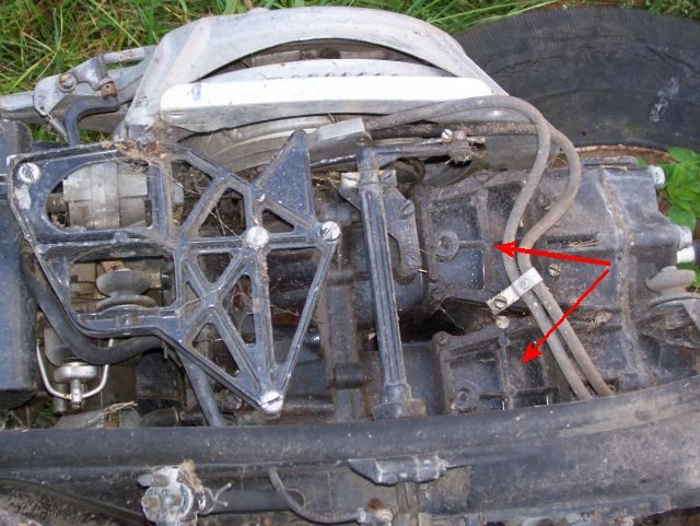

Or you can drill the upper plate on your motor and install a pump
I use a #15 drill bit to drill A all the way through (any size near that will work) then I tap the Bs for a #10 screw (some time they are already taped)

If the motor is a 30hp, it will not have the handy pre-cast-in boss on the intake cover...

If it is a 30 Hp then it is a 1956
the only year that Evinrude made 30 Hp (without fuel pumps already installed) is 1930 and 1956
However in 1956 through 1959 they used the same bypass cover
You drill the bypass cover...back part of the power head port side..two of them ...drill the one that is easiest to mount the pump to
My 1955 25 hp has the same covers....however I am not sure if those are the cover that cam with the motor
That pic is cropped a little too close. Is that the plates on the side of the cylinder intake passages from crankcase?

n0ukf wrote:
Are you sure that that motor is a 1957...the cover is the same as I have on the lower of my 1955 25 hp...and 30 hp were 1956 may be an early 56 ..can you post the Mpd#
Drill and tap one of the plate for a hose bar fitting. Buy this pump (item #1)first as to know what bar fitting you need. (get one that turns at a 90 degree if you can...it helps.)...Yes I know that it is a Honda, but it works and the price is real nice
www.boats.net/parts/search/Honda/Generator/0/EN2500%20AL%20GENERATOR%2C%2 ...
