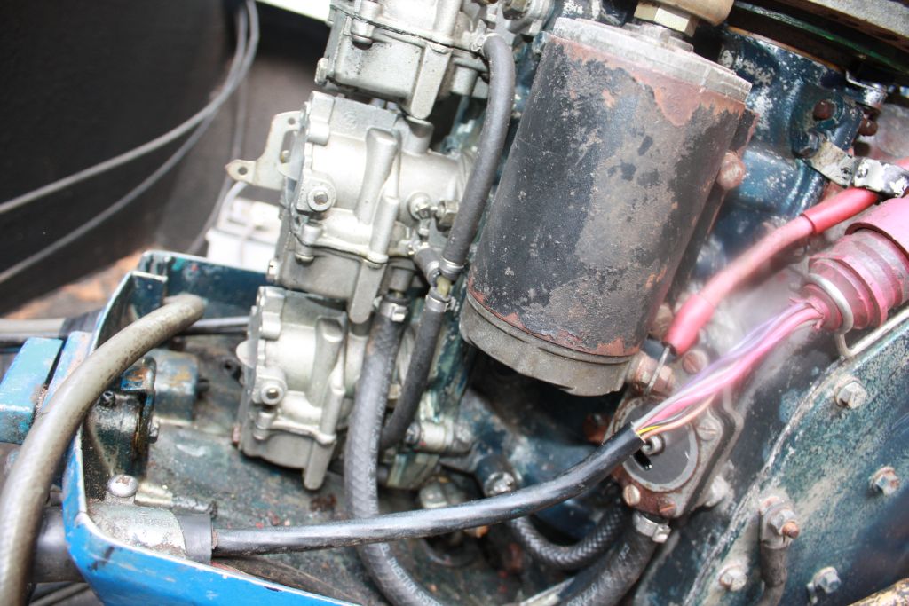

I put it in storage four years ago after replacing two coils and getting it running well. Put it on my Fabuglas today and I don't even get a burp. Spins over fine though. Sun's too bright to tell if I have spark. Any suggestions for something to check in the tropical sun?

Re:1976 looper won't start 15 years 4 months ago #34290
Looks like a " salt water special "
You do have the bits that go in front of the carburetors I hope.
