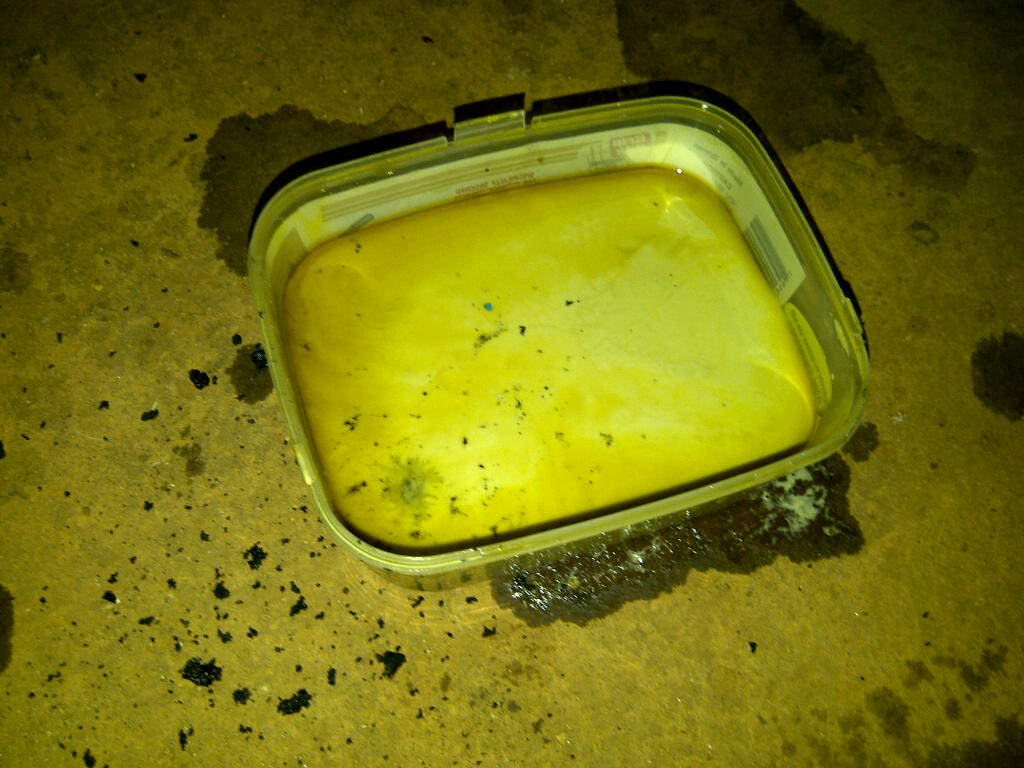

The o-ring at the top of the drive shaft was no where to be found, the fresh lower unit oil I put in right before the lake run was milky, and there lower unit oil goo where the drive shaft links to the cam shaft in the power head.

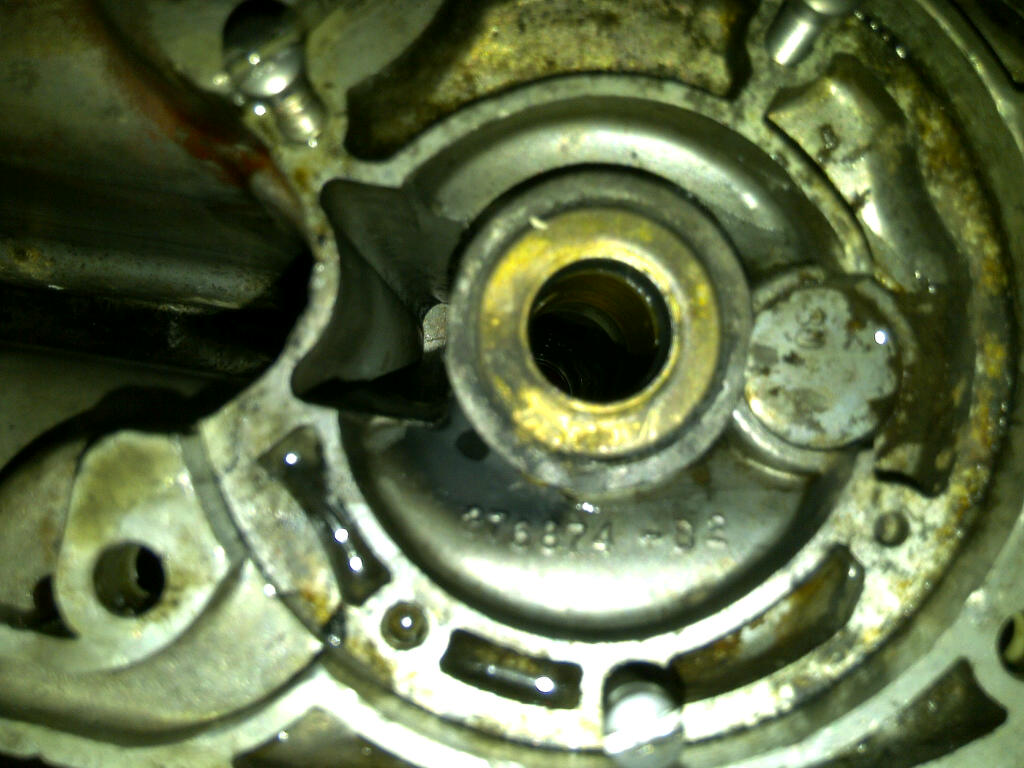

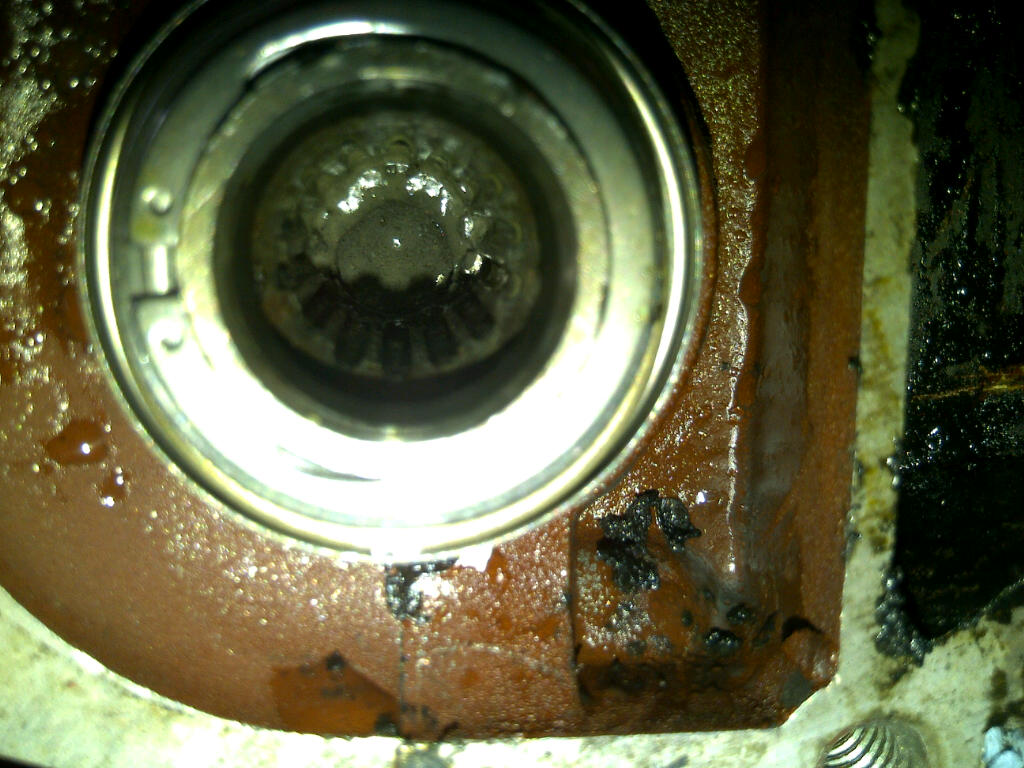

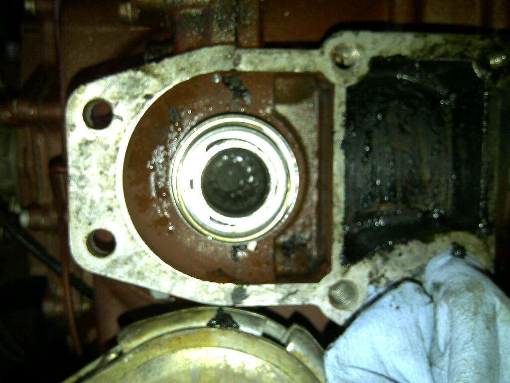

Here's some pics of the seal I need the tool for, the lower unit oil and the drive shaft receiver-This is viewed looking up into the powerhead.

You are meaning the leg..Ex tube....Item #66
Just wash best you can with soap and water and that is all. The O ring on top of the shaft had nothing to do with the oil leak
go to NAPA and get a LU kit (Sierra pt# 18-2686) and replace..the LU should hold 4 PSI for 10 Min (or longer)
www.go2marine.com/search.do?q=18-2686

Re:35HP Seahorse-lower unit oil @ top end driveshaft 15 years 1 week ago #32588
The confusion just never seems to go away !
there is an o-ring on the driveshaft.
When you assemble you put grease on the driveshaft splines.
The o-ring seals water out of there.
Nothing else goes wrong there.
Now if the carbon seal is broken on the crankshaft you will have to pull the power head to look at / replace it.
YOU DO NOT CLEAN OIL OUT OF THE DRVESHAFT RECEIVER , what ever you mean by that.

In the last picture you can see some old grease up in the end of the crankshaft where the driveshaft splines go in, is that what you're talking about Rob? If so, a q-tip would get the bulk of it out, I don't think it's essential that it be pristine clean. Just make sure you put some grease on the splines of the driveshaft and install a good O-ring on the shaft before re-assembly. (Don't put grease on the end of the shaft, just the splines!) Glad you caught this issue before serious damage occurred. Any thoughts about pulling the other motor down for inspection too?

The area of concern is the end of the crankshaft where the driveshaft splines go in (thanks for the clearer description Mark).
On the initial inspection of the crankshaft end, because the grease was milky in appearance like the lower unit oil I had just drained, I thought some of the lower unit oil had made it's way up somehow into the lower crankcase.
I guess what I was actually seeing was grease that had been applied previously to the driveshaft splines that was contaminated with water. Is this more a more accurate/likely description given that the o-ring at the top of the driveshaft was missing?
If it is water contamination, how thoroughly should I clean out the old grease to keep new grease from residual contamination? Am I assuming correctly that even a little water in the grease reduces it's effectiveness?

Re:35HP Seahorse-lower unit oil @ top end driveshaft 15 years 1 week ago #32601
Water and oil mixed from the exhaust is likely what you were seeing.
Can be found all over the driveshaft and inside of the exhaust housing.
