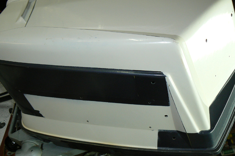

I'm assuming this is Fathom Blue and Surf White on the cover

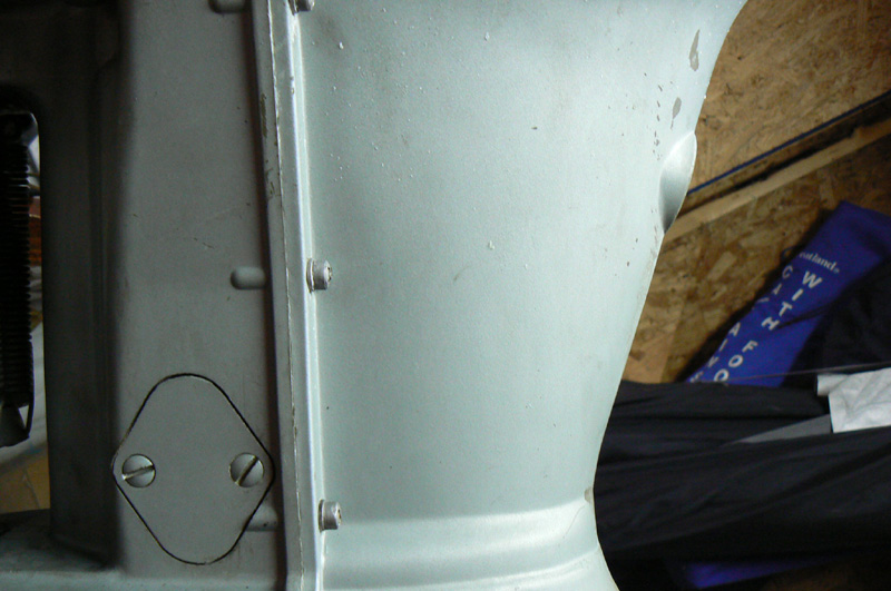

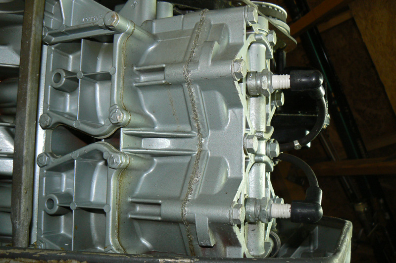

I'm also assuming this is the Platinum Mist on the engine and Lower unit not the Shark Grey
I want to repaint the cover since the idiot that I am tried to wetsand and buff out the paint! Forgot that paint wasn't real think and the edges always expose first. :S Should have left well enough alone.
So do I lightly sand with 320 then prime with a regular non-etching primer then paint? I know NY Marine has the paint but looked a little expensive and he says on the website that the rattle can is softer than using the other he has with the catalyst.
