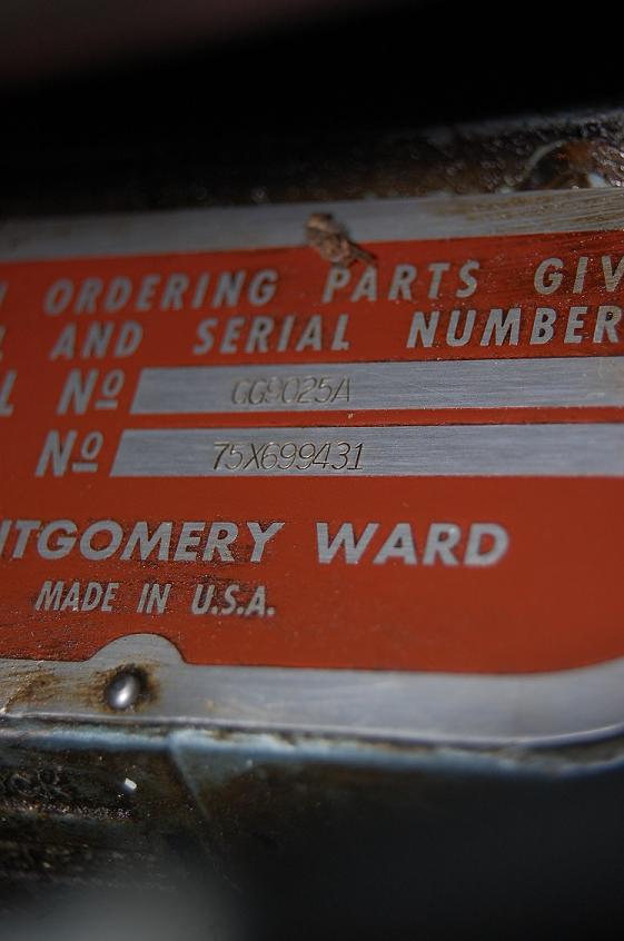

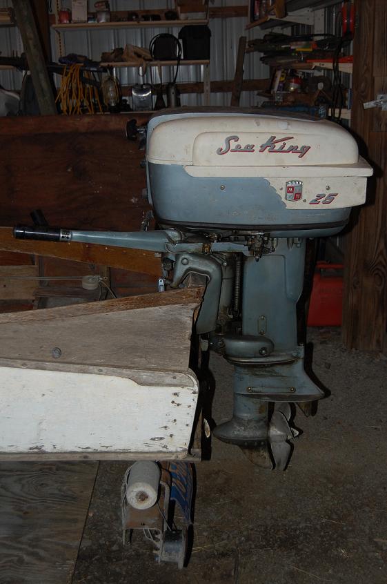

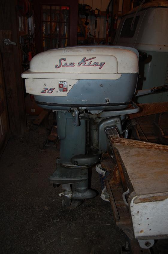

So my father and I just got this from a friend of ours to get running again.. I know nothing about it aside from that its a Johnyrude and a 25 I will post a pic of the serial if any one knows what year it is seems in great shape... well here it is.

Jesse,
Looks good, is it hanging on the back of that new racer you just picked up?
Re:New Horse in the stable! Sea king 25 15 years 2 months ago #31586
  • stashm2
  • stashm2's Avatar Topic Author
  • Posts: 666
  • Karma: 25
Yeah I didnt have another motor stand yet and the racer it just sitting there so we threw it on the back. looks nice ;-)
Re:New Horse in the stable! Sea king 25 15 years 2 months ago #31587
Sure does! Restore them both, they'll look good together, good combo.
Re:New Horse in the stable! Sea king 25 15 years 2 months ago #31588
Great lines on the motor!.. always like that color combo for some reason.
Re:New Horse in the stable! Sea king 25 15 years 2 months ago #31590
I'm with Waterwings. restore both and run them together. B)
Mid 50s to 58?
Re:New Horse in the stable! Sea king 25 15 years 2 months ago #31596
Hello,
The information we have shows it as a 1957 model.
Regards,
Joe Poole, Jr.
Ferguson-Poole, Inc.
www.fergusonpoolemarine.com

The cross reference on my site ( www.agott.com/glassboat/Manuals/SeaKing.pdf ) also shows that it's a 1957, and that it is equivalent to a Gale model 22d14.

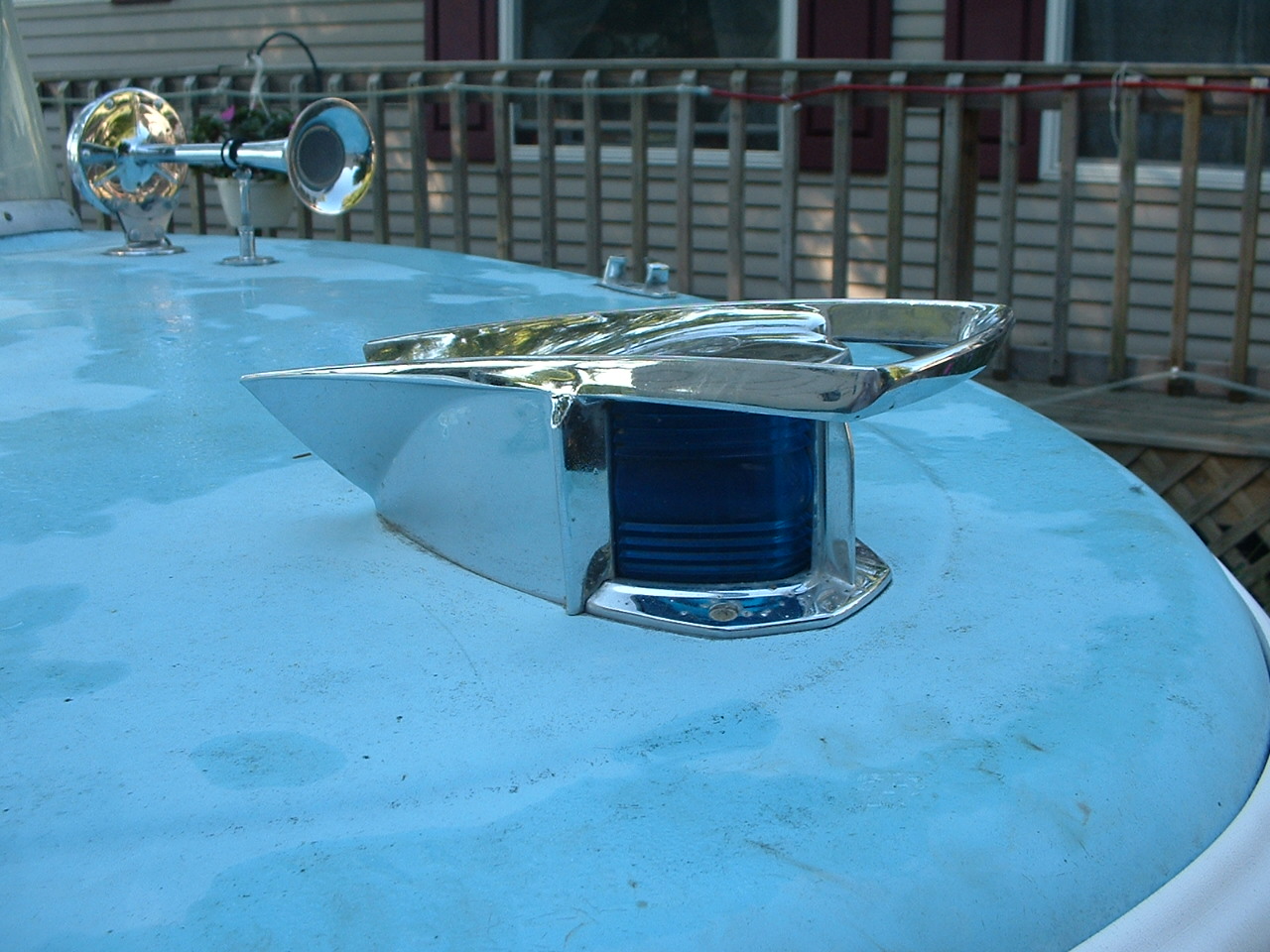

I want that bow light with the bergee pole in the picture

That photo was submitted to the Fiberglassic calendar shown on the month of April.
That burgee has a small crack in the base. That's why I use it for display purposes. I use a night light and a timer to light it up at night. I do have a spare bow light like that. That same light is mounted on my Larson All-American powered by a 59 Evinrude Fat Fifty. That 2 blade prop fits the Fat Fifty.
