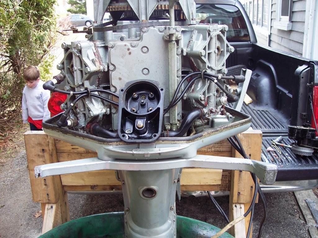

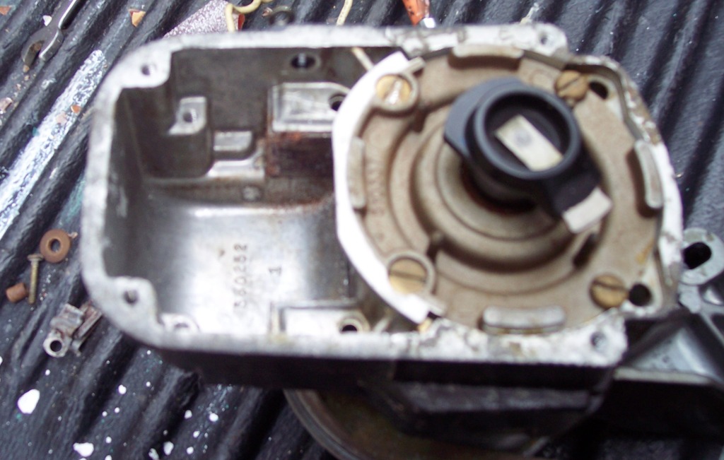

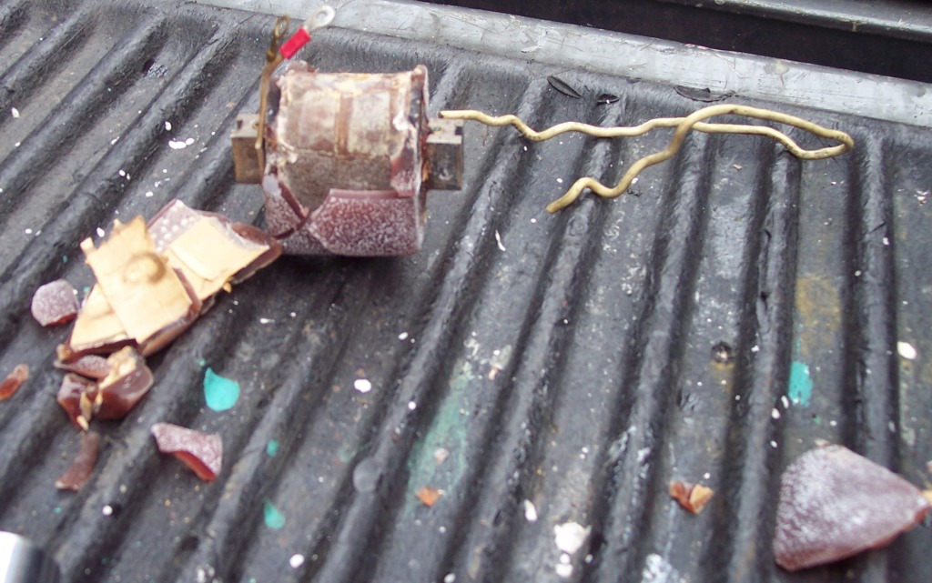

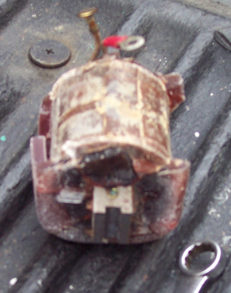

The magneto in the distributor was all crumbly thus leaving me with no spark. Anyone know where I can get a magneto?
thx
Jim

Jim,

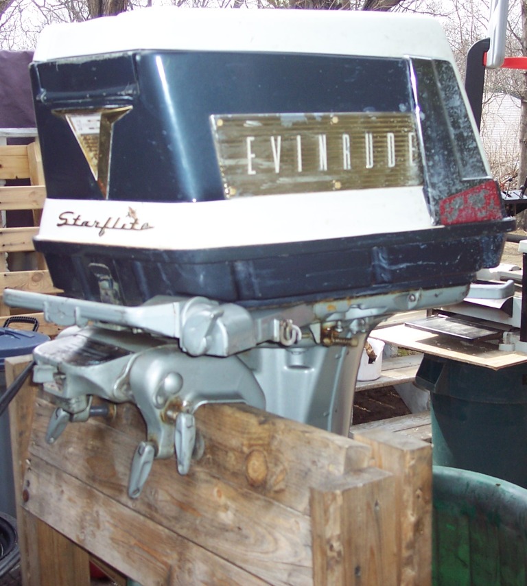

That's in great shape, looks like mine! Not sure about the magneto. Maybe Bruce Gerard knows. I'm going tp start that Fat Fifty hot rod post soon.
Re:picked up another 1959 Starflite V-4 50 15 years 7 months ago #29299
Jim, if you can give me the number stamped into the outside of the magneto housing, I'll check Monday and see if we can get you a coil. (Some still available New).

Hey very nice looking motor I just looked at two of those today in Ft Worth. Never seen one in person little bit bigger that what I need. So he said he was going to part um out. Let me know if your still looking. One was on a boat other was out back both looked ok pulled one felt good compression and free.

thx guys! Mark I will post the model # shortly.

Model Number is 50518 on this motor. I think I have a magneto coming. New they cost about $200 I got this one for $80 w/shipping

You should be able to use and mag off a V4 on that if I remember right
And I have one of those motors. I took the reed out of one of my dead V4 75hp and put in it. waiting for the parts to make it a short shaft.

well....I held out a bit and found a NOS one for $68. I feel better about that than used for $80
Re:picked up another 1959 Starflite V-4 50 15 years 6 months ago #29575
Thats good Jim new is always best when it comes to electrical, if you can find uml

Great looking motor, Jim!
I just put a nearly identical one on my 16' Glasspar. LOVE it!!

In this thread, I see talk about the good looking motor etc. Where are the pictures posted at? They don't show up on my screen or I don't see a place to view them at.

All it shows is your first post to this thread, but there are no attachments or pictures shown. Is there something to click on to to get them to appear?

nope. the pics are there. I can see em. I will attach some of them again

There that is better, I can see it all now! Good looking motor!
