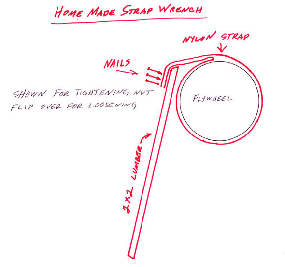

I use a homemade strap wrench that uses an old serpentine belt.
Re:Unsticking a '59 Evinrude Lark 35 hp 15 years 7 months ago #28021
Here is how you can make a flywheel wrench. Easy to make using 2x2 and some kind of strap.
Mike aka pathfinderz1
