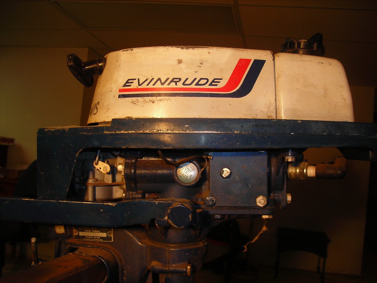

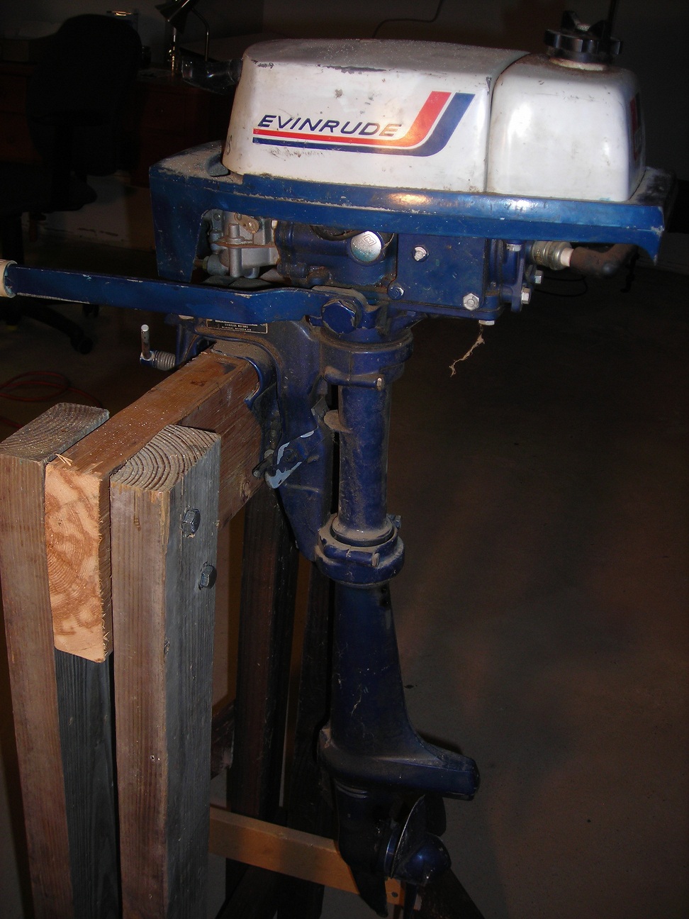

Sorry this post got kind of windy. A few pics of the motor before cleaning.

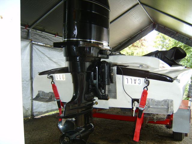

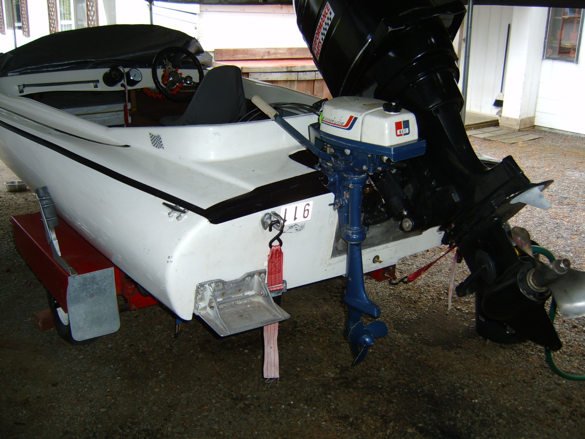

Heres one for ya, a pic I took, off my Flatbottom monster. as live with here WA, Puget Sound, zillion miles water of water, if going somewhere way out, I stuff it under the bow..needed, clamp and go, just hope enough beers, at 2 mph, to get me home!

Oh yeah, if any curious, that upside down, "911". Heres another pic..(boat bought off Doc Frankenmerc, and he's a cop, and he built the crank up fresh rebuild, the "TOP..!..little .."play on words", get a grin off it others too..
