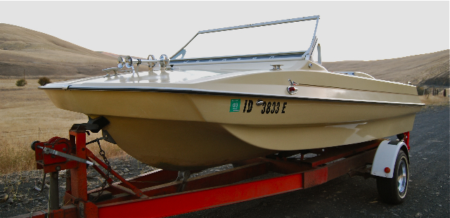

HI, just dropping in to introduce myself and my Johnson Reveler which I just got in trade for my 1972 Bell Boy 21. Im looking to replace the horns on the bow, anyone know where a good place to look online would be?

Welcome, Grae. Good looking Reveler! I found a set of 12V horns similar to yours on www.westmarine.com , just search boat horns and they will pop up. I'm sure there are many others out there on the internet, possibly someone else will enlighten us. Those are also available as "air powered", but 1 - mounting a compressor, and 2 - waiting for the compressor to build enough pressure to blast the horns made me decide on 12V versions.
www.iboats.com also offers several, always pays to shop around.

Thanks guys! The Rev is a 1968. I have been working on her for a few days, mounting new fuel pump ( had to ditch the electric one ) and repairing a hole in the gas tank, but i hope to be taking her out on the lake tomorrow!
Thanks for the lead on the horns. Not sure how to test 100% if they are actually failing, but ive got plenty of voltage going to to them ( says my DMM )

Grae, you've got juice to the horns but did you also check to make sure the ground wire was intact? Excuse my ignorance but I'm not sure what you mean by DMM. A simple test light out at the connections to the horn will tell the story, just wondering. If you do have ground, replacement may be the only option. The diaphrams may be shot requiring replacement of the unit.
